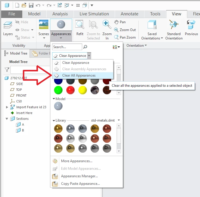

Creo 5 user here. As you may have experienced, when you import a STEP file, sometimes the original designer exported it such that the material or colors caused the exported file to contain colors on the surfaces of the part.
Is there a quick shortcut to make the entire part or assembly go to Creo's default gray without going through the material editor and editing the colors?
I'm importing more and more black-colored parts and it's difficult to discern geometry.
Best answer by TomU
View --> Appearances --> Clear All Appearances

You are a gentleman and a scholar. Much appreciated.
April 13, 2019
It's indeed a good interactive solution. you might even want to create a mapkey.
Did you try importing the model with a template? This template would have no appearance. Hence when importing the step file the template none appearance would be applied to the model.
