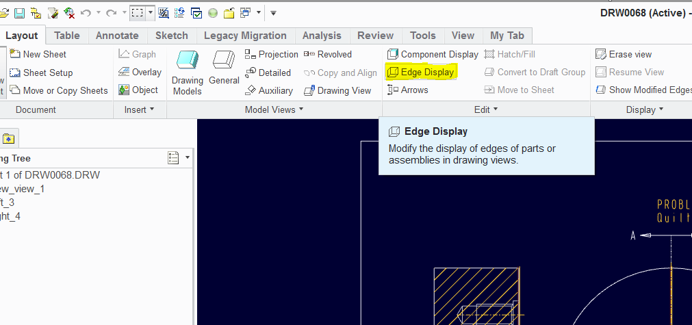

Oh, yes, that. For some reason, you cannot hide the original feature. In the drawing, you might be able to erase the lines using the edge display dialog...
You can also try an extrude/cut to completely cut the original object out of there.
