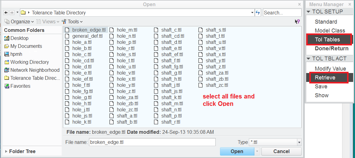

I am not sure what note are you creating in a drawing.
Load ISO tolerance tables must be done in model, see following picture.

  • open model template
  • change tolerance standard to ISO
  • load ISO tolerance tables
  • save model template
  • use model template to create new model
MH
