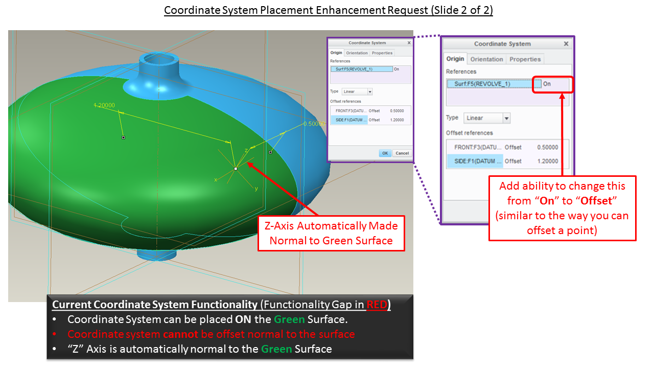

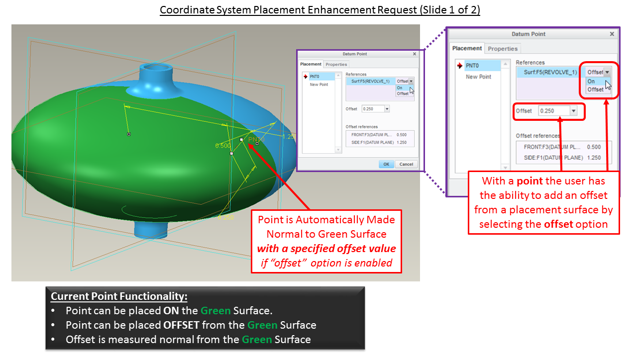

- Use Cases are very helpful. "Use case" is a term we use to describe a particular work scenario that requires attention or demonstrates the need for a particular enhancement. For example, this is an example of a "use case" (this is a real request I've submitted):
- "I have an irregular surface - such as an elliptical tank. I'd like to drop a coordinate system offset from the irregular surface such that one axis of the coordinate system is always normal to the placement surface but offset at some height above the surface. Currently the only way I can do this is to add a point on the irregular surface offset by the appropriate amount, then add a coordinate system on the point. It's possible to drop a point on a surface offset by a specific height and it's possible to drop a coordinate system on a surface with the normal automatically adjusting to the surface but it's not possible to create a coodinate system with an offset and the automatic normal. See slides below (click for larger images)...
A picture is definitely worth a thousand words in this instance. The better you can describe your issue, the easier it is for me to bring it to the attention of the PTC developers and Product Line Managers.
