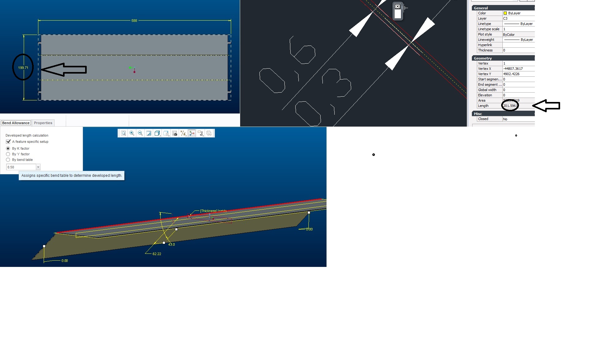

i have a problem and i don't understand
i have 0.6 thickness ,
i chose k=0,5 in creo , and 0.5 in other 2d program
but developed lenght is different what is the reason for this
was happened?
where i make mistakes?
tks in advance
December 2, 2015
Creo uses the Y-factor by default while most other software uses the K-factor.
Did you set the sheetmetal module to use the K-factor value or just use the default value, which would be a Y-factor of .5?
