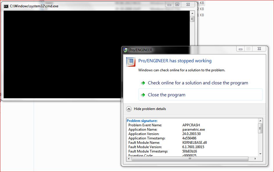

    June 9, 2013
    Dear Antonius Dirriwachter
    I have attached the script i modified and run as you said, but app crash saying now. what should i do?
    I have attached modified script and and screen shot of error.
    Kindly review it and help me.
    To sort it out.
    Else you advise me how to create basic script. attach me document.
    And have another question should I add any other in environment variables (variable name & variable value on user or system).
    Thanks&regards
    Viswanathan.K
    June 9, 2013
    I guess that wasn't it... but if you look at your script, I suspect you have 2 backslashes when you joint the variable with the path:
    @echo off
    :: Set Environment Variables
    set proe_load_point="C:\Program Files\PTC\Creo 1.0\"
    :: Launch Pro/ENGINEER
    call %proe_load_point%\Parametric\bin\Parametric.exe
    @echo on
    exit
    C:\Program Files\PTC\Creo 1.0\ + \Parametric\bin\Parametric.exe =
    C:\Program Files\PTC\Creo 1.0\\Parametric\bin\Parametric.exe
    Also, Parametric.exe is actually parametric.exe ...not that this should matter.
    Try removing the quotes and correct the double backslash
    Check your work by typing "SET" at the command prompt and see if it shows a valid path. (comment out the "call...")
