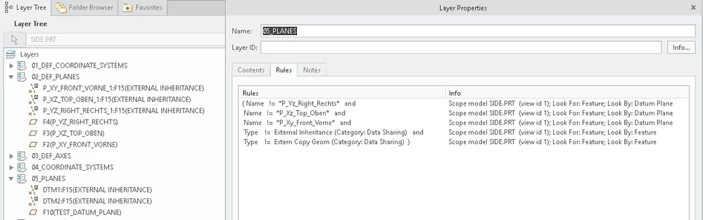

I have a layer 02_DEF_PLANES for default datum planes, including them by name. I have another layer 05_PLANES for all other datum planes, excluding the default datum planes by name. This one works.

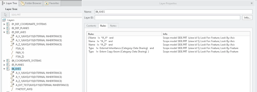

I also have a layer 03_DEF_AXES for default datum axes, including them by name. I have another layer 06_AXES for all other datum axes, excluding the default datum axes by name. This one just ignores the naming rules and puts the A_X, A_Y and A_Z axes from the external inheritance on the 06_AXES layer. Note that these axes are NOT on this layer in the inherited part.
What is going on here?
Layer rules also do not apply at all to items from external data on layers with the same name. In my examples datums from the external inheritance are placed on layers where I have excluded them by rules.

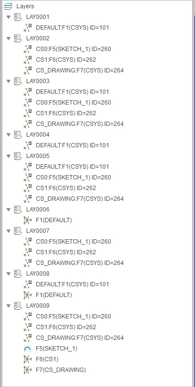

Not exactly, that's why I'm wondering what is being searched by on your 01 and 04 layers. Here is an example of what I'm referring to and see if they make sense to you. I'll include how I interpret what I'm seeing.
  1. LAY0001 searches for a coordinate system with Look for: Coordinate System, Look By: Coordinate System, with Attribute Name: *DEFAULT. Datum DEFAULT is placed on layer.
  2. LAY0002 searches for a coordinate system with Look for: Coordinate System, Look By: Coordinate System, with Status: Layer: Not Included: LAY0001. Datum DEFAULT isn't placed on the layer since it's included on LAY0001.
  3. LAY0003 searches for a coordinate system with Look for: Coordinate System, Look By: Feature, with Status: Layer: Not Included: LAY0001. Datum DEFAULT is placed on the layer since LAY0001 doesn't have a feature on it named DEFAULT.
  4. LAY0004 searches for a coordinate system with Look for: Coordinate System, Look By: Feature, with Attribute Name: *DEFAULT. Datum DEFAULT is placed on layer
  5. LAY0005 searches for a coordinate system with Look for: Coordinate System, Look By: Feature, with Status: Layer: Not Included: LAY0004. Datum DEFAULT is placed on the layer since LAY0004 doesn't have a feature on it named DEFAULT.
  6. LAY0006 searches for a coordinate system with Look for: Feature, Look By: Coordinate System, with Attribute Name: *DEFAULT. Feature DEFAULT is placed on layer.
  7. LAY0007 searches for a coordinate system with Look for: Coordinate System, Look By: Feature, with Status: Layer: Not Included: LAY0006. Datum DEFAULT isn't placed on the layer since it is part of the Feature DEFAULT definition.
  8. LAY0008 and LAY0009 used OR rule definitions to get items on layers.
In order to make sense of the pics of the layer definitions shown I'd need to see the rules for layers 01 and 04
and what ends up on them.

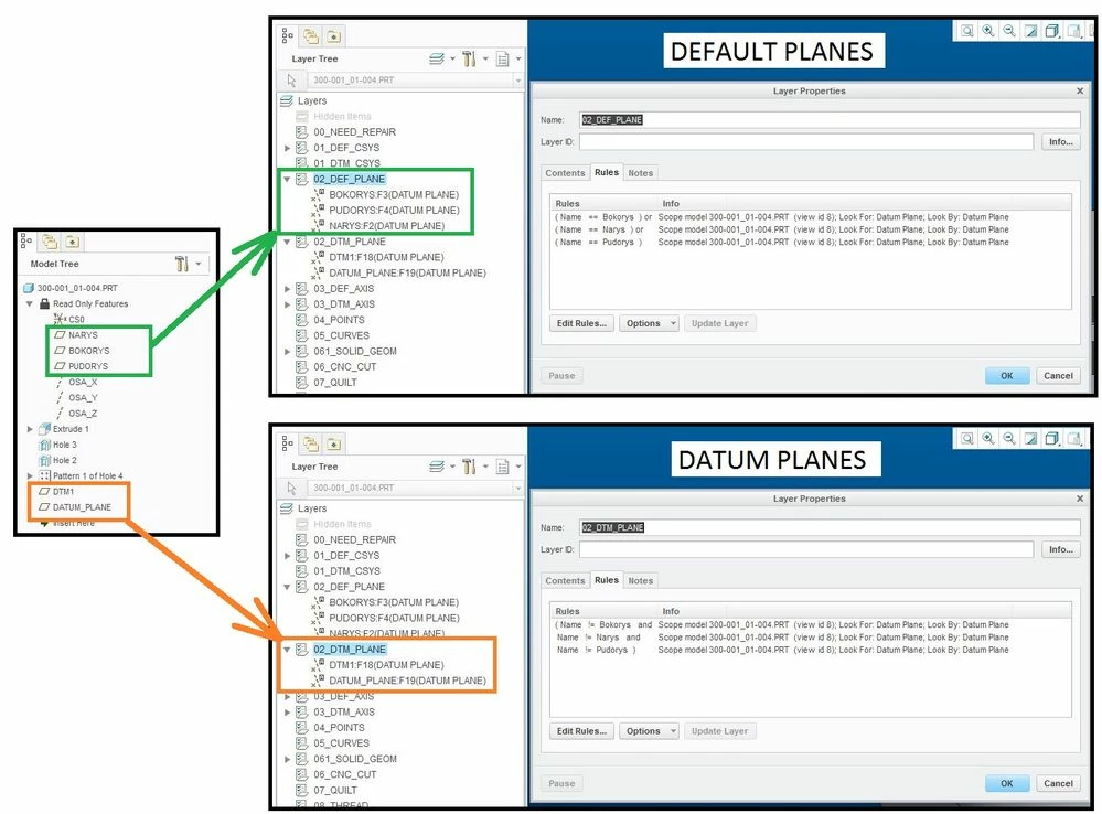

 got similar layers structure. You are using "AND" condition for default planes and it´s the core problem (in my opinion). Try to use "OR" instead of this. See following pictures from mine solid_start_part.prt. Plane names are different, but logic should be the same... In general:
1) Default planes - include plane that name is "bokorys" OR "narys" OR "pudorys"
2) Datum planes - inlclude all planes that name IS NOT EQUAL to "bokorys" AND "narys" AND "pudorys"
Keep same logic for coords, axis etc...
See attached part...
Regards
@mbonka

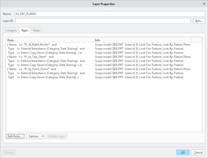

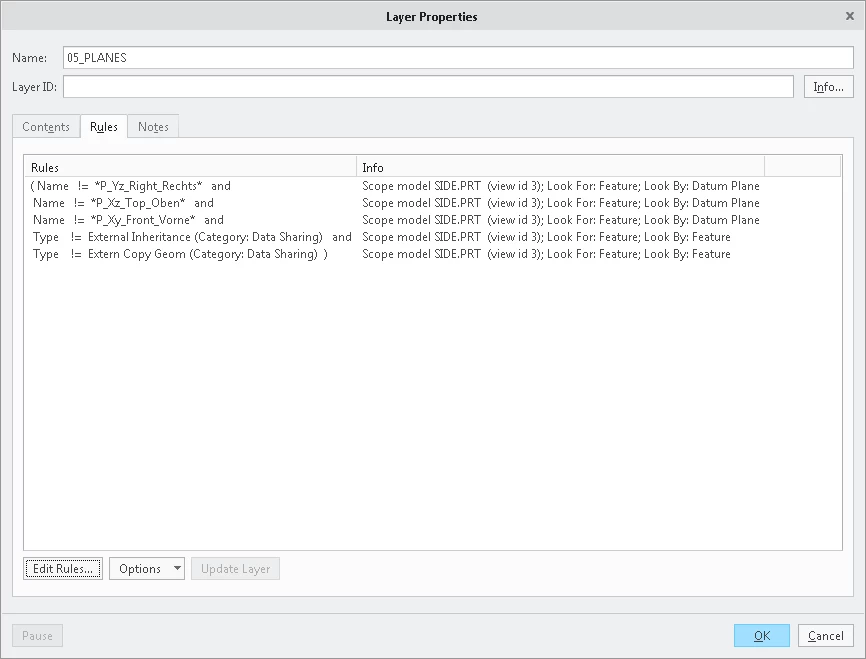

Hello @@mbonka
Thank you for your reply. Your rules seem to be setup in the exaxct same way as mine (same logic). See the attached example pictures:
Default Planes:
Other Planes:
The issue I was describing was that sometimes rules for one type of feature work while the same rules applied to another type of feature don't work. I showed only the layer rules for non-default datum planes and non-default axes to show that sometimes the rules ignore items in external inheritance features and sometimes they don't. I haven't found out why yet...
