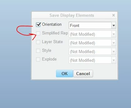

Hello
Is there any way to Link the Simplified Rep to an specific Orientation
If yes. will save many clicks to me!
Thanks in advance
    February 16, 2017
    You can set up a combination state (in the "All" tab of the view manager) that uses a simplified rep and sets an orientation.  You would have to do this for each of the simplified reps that you wanted to have a specific orientation.  Then you would use the all tab of the view manager to activate these instead of the simplified rep tab.

    eXCELENT.. THANKS@
