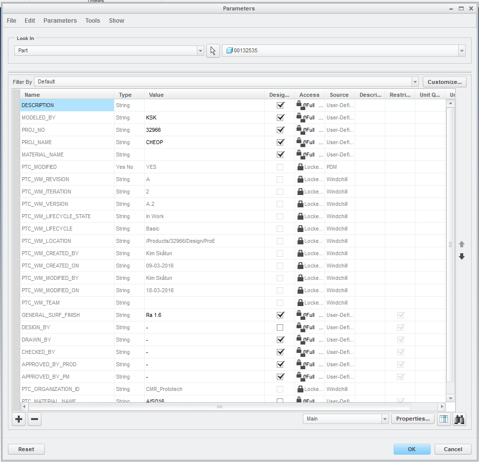

Well what i ment was that i want to pass model number, project number etc to my script. Pretty much like u said mapkey(continued) @SYSTEMZ:\\folder\\subfolder\\script.VBS variable
However the variable should be model name/number, so if i run my mapkey with part 1234.prt as active it will be @SYSTEMZ:\\folder\\subfolder\\script.VBS 1234
and if then 2345.prt is active it will be @SYSTEMZ:\\folder\\subfolder\\script.VBS 2345
In table in drawing mode/relations etc you use %PTC_MODELNUMBER but i am unable to get this to work in mapkey.
So basically what I want to do, what I now do manually outside creo is:
I have finished making a part, I then want to let our project leader know about this as well as our drawing expert(it also add it to the list of parts to be produced,etc..). So my nice excel script do all this, but i need to type in the filename manually, and i would like to avoid this step.

kskatun10-MarbleAuthor
March 18, 2016
We store the information in parameters in the model. I started to look autohotkey, seems promissing:)
