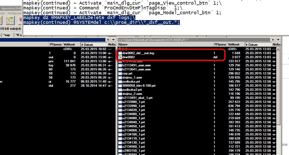

I would like to get rid of log files generated during dxf export.
I found a PROE discusion where there is a mapkey created for this purpose: mapkey(continued) @SYSTEMdel c:\\proe_dir\\*_dxf__out.*; but it does not work for me.
Also I dont know how to change the path to my current working directory.
the whole mapkey looks like following:
mapkey dxf @MAPKEY_NAMEExport do DXF;@MAPKEY_LABELDXF;\
mapkey(continued) ~ Command `ProCmdEnvHidden` 1;~ Command `ProCmdModelSaveAs`
mapkey(continued) ~ Open `file_saveas` `type_option`;~ Close `file_saveas` `type_option`;\
mapkey(continued) ~ Select `file_saveas` `type_option` 1 `db_137`;\
mapkey(continued) ~ Activate `file_saveas` `OK`;~ Activate `export_2d_dlg` `OK_Button`;\
mapkey(continued) ~ Activate `UI Message Dialog` `ok`;
thanks for help in advance
T.
Best answer by MartinHanak
Tomas,
mapkey cannot work, because it removes files from c:\proe_dir directory.
Your working directory is c:\Users\hlavinka\Documents\473-4430\2, try the following mapkey.
mapkey ddd @MAPKEY_LABELDelete dxf logs;\
mapkey(continued) @SYSTEMdel c:\\Users\\hlavinka\\Documents\\473-44\
mapkey(continued) 30\\2\\*_dxf__out.*;
The mapkey is not universal !!!
Martin Hanak

thlavinka1-VisitorAuthor
March 25, 2015
Hi Martin,
I tried it and seems it does not work
March 25, 2015
Tomas,
Martin Hanak
