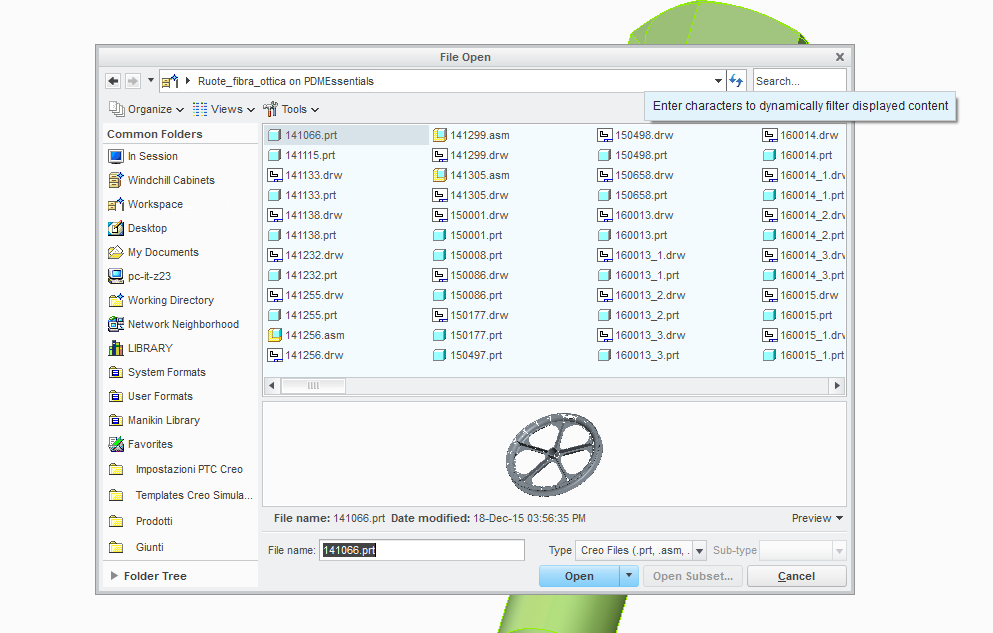

I would like to record a mapkey which allows me to show the file open window and click with mouse pointer in the search bar ("enter characters to dinamically filter displayed content") in the upper right corner of the windows, so that I can type directly the file I want to open:
I tried to record it, but it only opens the windows (and If I type, keystrokes appear in the File name bar below.
(an alternative to this is to type the filename in the bar below ("File name:") but the unconvienent in this is that you have to remember the exact filename to spot the part (while this is not the case, many times).
anyone has a suggestion in order to fix this? ( maybe to add some string text in the mapkeys file?) or have a workaround...

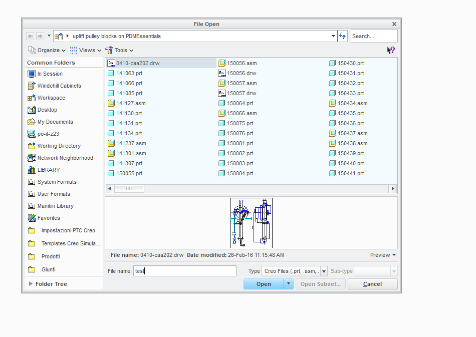

I tried your mapkey but when I press the key this message appears:
and then if I type something in that bar ("test") and press ok, the file open windows appears with the word typed in the file name bar below:
while instead I am searching for a way to have the cursor directly in the upper right search bar:
because in the file name below bar you have to type the entire file name including its extension.

I have been able to solve the problem by creating a mapkey which recalls an external OS script written in autohotkey. The mapkey is the following (in square brackets the custom texts):
mapkey [mapkey key sequence] @MAPKEY_NAME[mapkey description]; \
mapkey(continued) @MAPKEY_LABEL[mapkey label]; \
mapkey(continued) ~ Command `ProCmdModelOpen`
mapkey(continued) ~ Trail `UI Desktop` `UI Desktop` `DLG_PREVIEW_POST` `file_open`;\
mapkey(continued) @SYSTEM C:\\[path to the script file]\\scriptname.ahk;
this mapkey firstly opens the File Open window, then recalls the script file "scriptname.ahk", which in turn activates the "File Open" window (necessary step since at the moment of the script launch the active window is not the Creo File Open window), and presses 3 times the Tab key.
The autohotkey script contains just the following two lines:
WinActivate File Open
Send {TAB 3}
two little unconvenients of this procedure are:
-the appearance of the black DOS command window for a fraction of second
-the process lasts 0,7 second (so not as fast as expected)
(but works fine anyway).
As an alternative, instead of the ahk script, a VB Script could be put in, with which the black DOS window can be hidden and maybe it's also faster (but I don't know how to make a VB Script ).
(Any alternative suggestion is welcome anyway).
