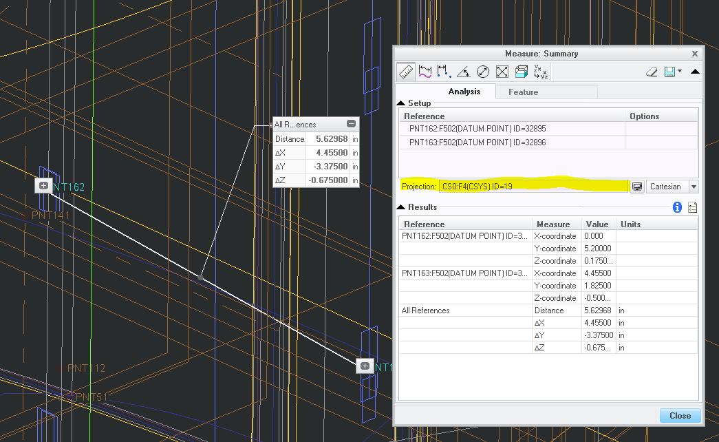

I'm new to this forum so please be gentle. Currently using Creo 2.0
Quite often I want to measure distance from a midpoint of an edge in a feature/part to a midpoint of an edge in another feature/part. The distance is to be projected to a common parallel plane/surface. The edges may or may not be in the same topology. This shouldn't be rocket science.
Went thru all the filters in the analysis > measure distance mode and no luck. It would be great if the analysis tool would allow you to snap to the midpoint of an edge when you activate the edge filter. Hint Hint PTC
So the only way I'm able to achieve such measurement is to create a sketch on a parallel plane/surface where I project the edges of interest as curves. I then add center construction lines and midpoint-constrain them to the projected curves. (get it? midpoint constrain?) I then add a ref dimension.
I've added some screen shots to explain the scenario better.
Is there a less rookie way to do this? I really want to avoid going to sketch mode every time and would like to achieve this measurement in, you know, the measurement tool.
Best answer by dgschaefer
While in the measure tool, you can create datum features on the fly to assist in your measurements. So, you can create a point at the midpoint of edge 1 and another at the midpoint of edge 2. The nice thing about this is any datums you create while measuring are temporary and will be removed once you exit the measure tool.
There's also a projection reference tool within the measure dialog to show the distance as projected on a plane or, if you pick a CS, it'll give you the X, Y & Z distances.
May 21, 2015
Also, add "measure_dialog_expand yes" to your config.pro to force the measure dialog open by default.
