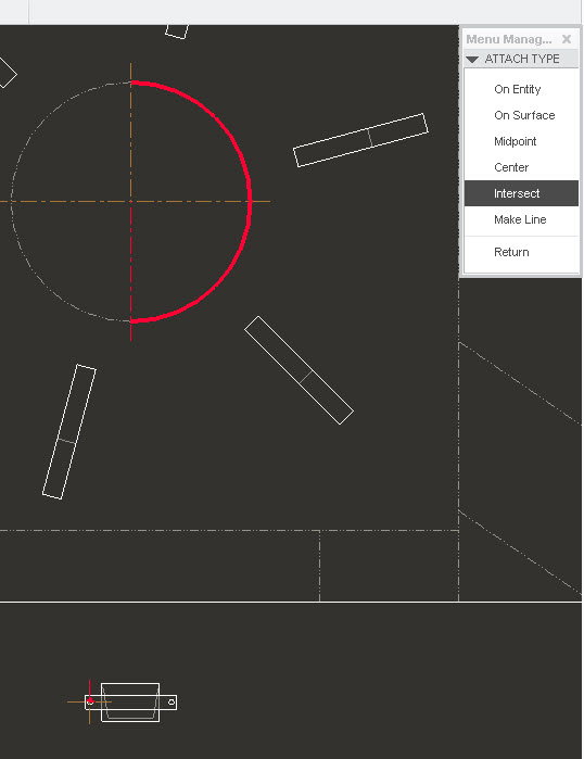

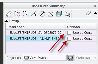

I need to define the distance between two edges.  They are both round.  I want the minimum distance and not the center to center.  How do I do this both in the measure tool and also in my drawing.  See below:

In the measure tool, by default it will go to center-center on radii. Unclick the "USE AS CENTER" in the dialog box.
In the drawing, in your example, I would create a dimension select the 2 radii and select tangent for both in the menu manager. It's sensitive to where you pick the radius, so don't pick to close to an endpoint.
Other methods for the drawing are to use intersect when creating the dimension (pick your radius and the centerline you have shown for each point) or to create the feature using a construction point and dimension it in the model and then just show the dimension.
dbolden1-VisitorAuthor
February 4, 2016
This is an assembly.  I tried to create a dimension in the model using the tangent and then vertical options but it still places a .376 dimension to the larger dimension.  I should be getting .002.  It snaps to the tangent further up on the top radii.
When I try to dimension within the drawing it doesn't let me choose (2) entities.  Even when I hold the control key when I click the second line it wipes out the first.
When I try to do this as construction geometry it doesn't let me exit the sketch because there is no real geometry.
