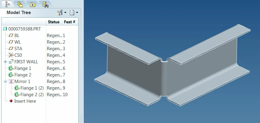

I've created a flange wall in my part that wraps around 3 straight walls and the bends in between (LH image).  I then cut out the deformed area (RH image).
[cid:image001.png@01CE09FA.BE412F20]  [cid:image002.png@01CE09FA.BE412F20]
In the flat, however, I get no bend lines for these walls.  I'm assuming that's because of how I built it.
Is there a way to get the bend lines, or do I need to remake these walls?
February 13, 2013
IMHO you will need to rebuild the part. Attached is a screenshot from Creo Elements/Pro 5.0 (aka Wildfire 5 1/2.)
