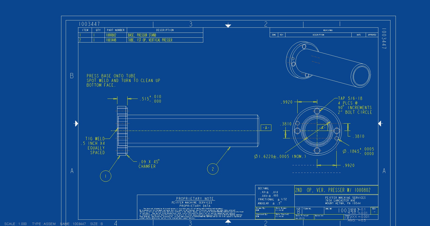

Hello Everyone, I am having an issue with hidden lines in the drawing as it is displayed on the monitor.   When I make each view "hidden" the hidden lines are the same color and pattern as the rest of the geometry.   however when i print or export to pdf or dwg it does show the hidden dashed lines.  I have been searching the forums and trying to tweak the pen table but no luck yet.   Any ideas to fix?

The attached file shows three views.  The ISO is no hidden lines and is fine.   The bottom left view is hidden lines turned on but shows the ID of the tube as a slightly different color and solid line.  Should be a dashed (hidden) line. 1003447.jpg

Jon,
Hidden line display as dashed line in drawing views was never a part of functionality. Hidden lines will display as light solid lines and will appear as dashed lines on print/pdf.
