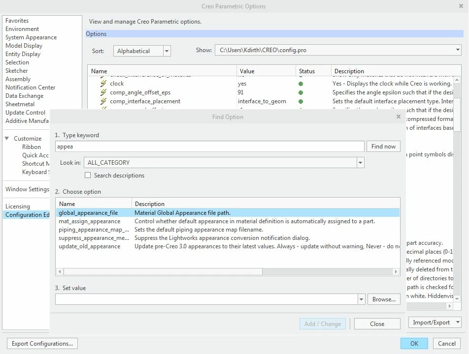

I am trying to modify the Library directory for the Creo-Appearence Manager.
In our actual configuration the path of the Libary is (Installation-Path)
C:\PTC\Creo 3.0\M130\Common Files\graphic-library
Instead i would need to provide an appearence Libary that can be edited by an Administrator on a Server-Path.
I know that i could use the "My Appearence" Tab, and simply browse the diffrent Library Files. (And preset the Standard-Searchpath)
But, the Folder Tree, thats avilable in the  Library-Tab would be a lot more user-friendly, because i will have to provide a big amount of Appearences. (diffrent .dmt-Files)
I couldn't find any Config-Options for this.
Thanks.

set config.pro option PRO_TEXTURE_LIBRARY
See http://www.proesite.com/cgi-bin/find_option.cgi?srch=PRO_TEXTURE_LIBRARY&ver=creo1

Is this what you are looking for?

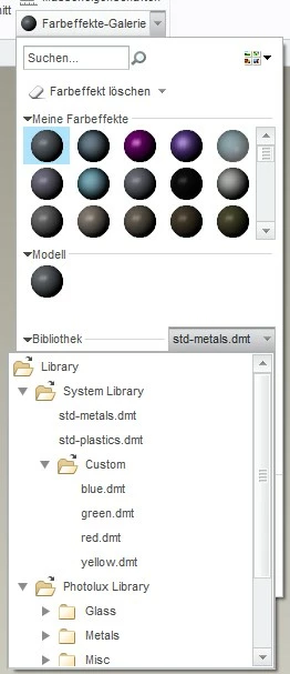

Hi Martin,
Thanks for the quick answer!
The PRO_TEXTURE_LIBRARY worked fine!
I had some troubles with setting up the library Directory, because the Folders kept appearing empty.
I found out, that the path you choose for your pro_texture_library has to be the Folder containing the libraryfolder.
For Example the "Common Files" Folder in Creo Installation-Path. This one has be set in the config Option.
the subfolder "graphic-library" contains the structure provided in your link. Then it works.
I already did Setup the File on Network and it seems to work as intended!
Thanks for the quick Response!
