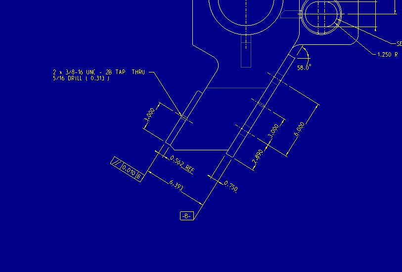

Having trouble getting my Datum B to rotate to the same angle as the part it is attached to which is 58 degrees. Any suggestions on how to rotate this to match with the Geo Tolerance?
September 22, 2014
Unless it responds to modifying it's attachment ... I don't recall a rule that says the datum reference symbol needs to be aligned with the surface, though I agree it would look better.
Mostly of concern, the 58degree angle isn't a good dimension to use as there is no 'horizontal' part of a part to determine what it is 58 degrees from.
