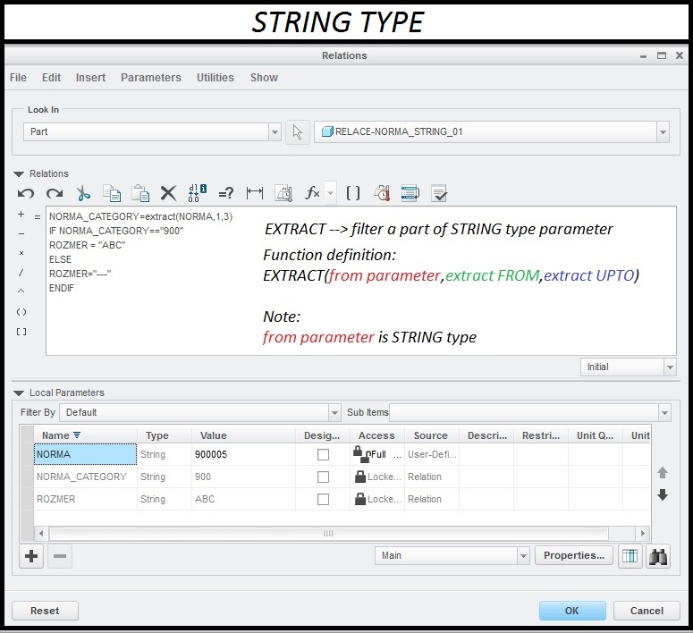

01) STRING type relation:
Princip:
- use EXTRACT function
- use help parameter NORMA_CATAGORY
- see ProE help or PTC community for more informations
Relation:
NORMA_CATEGORY=extract(NORMA,1,3)
IF NORMA_CATEGORY=="900"
ROZMER = "ABC"
ELSE
ROZMER="---"
ENDIF

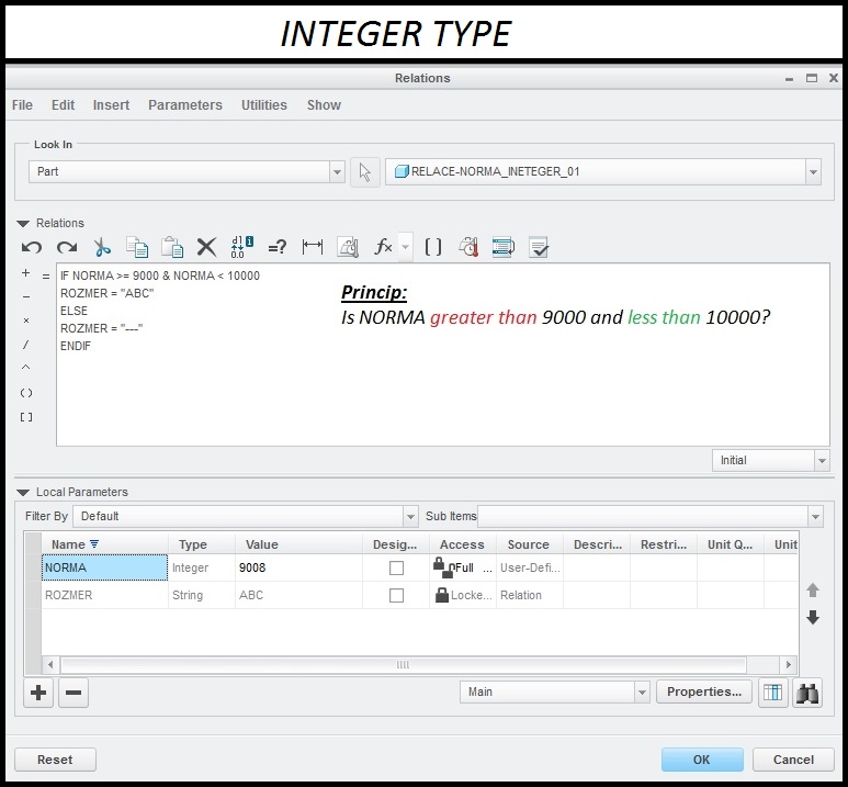

02) INTEGER type relation:
Princip:
- use standard mathematical logic ---> IS it greater than 9000 AND smaller than 10000 ?
Relation:
IF NORMA >= 9000 & NORMA < 10000
ROZMER = "ABC"
ELSE
ROZMER = "---"
ENDIF

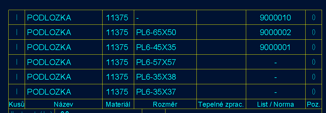

Tom,
Thank you for so quick answer.
I tried to write a relation according to you, but the result is still the same. Below I put a printscreen of drawing boom where all three items with numbers in collumn "NORMA" should have "-" in collumn "ROZMER"
March 5, 2016
Is Rozmer a parameter in your model, or only in the repeat region?  If you look at the cell properties at the top of that column, does it show something like &asm.mbr.Rozmer or &rpt.rel.Rozmer?
