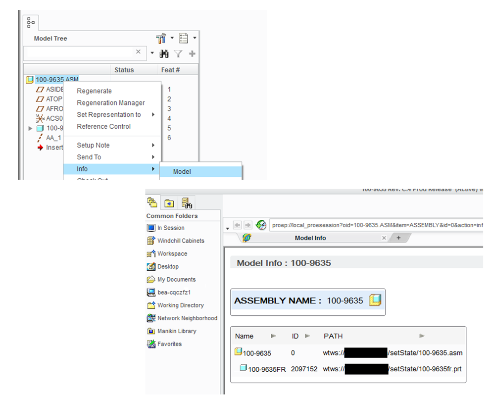

I wondered if it was possible to create a new column in the model tree that would display the file location of each part used in that assembly?? This would make it easier to see which parts needed to be replaced with the part from the correct file location.
If this isn't possible, does anyone have any ideas how I can quickly see the location details of parts in an assembly??

You may need to set this config option "display_full_object_path" to yes as well.
October 27, 2014
RMB on the assembly name in the model tree --> Info --> Model.

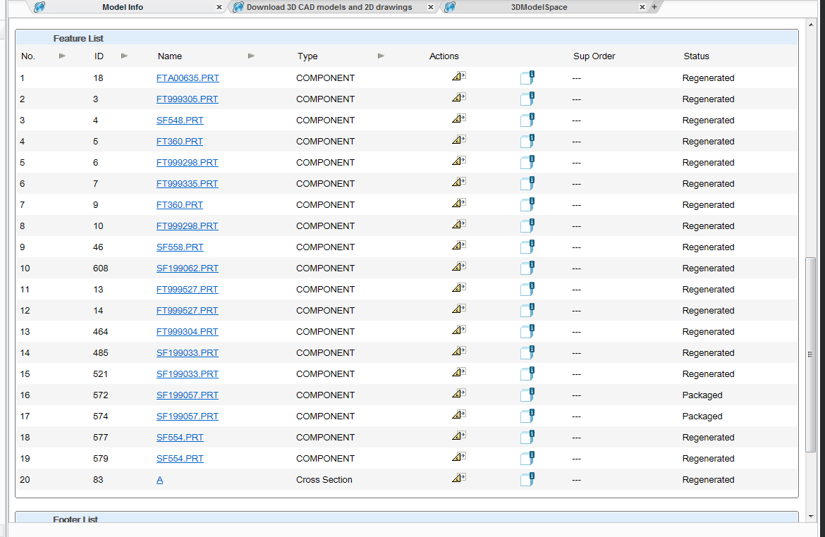

Thanks for that but it still doesnt give me a location for the individual parts? See attached screen shot.
I need to be able to see if a part is being pulled in from the project fold or pulled in from the correct database storage?

James,
It works for me.
