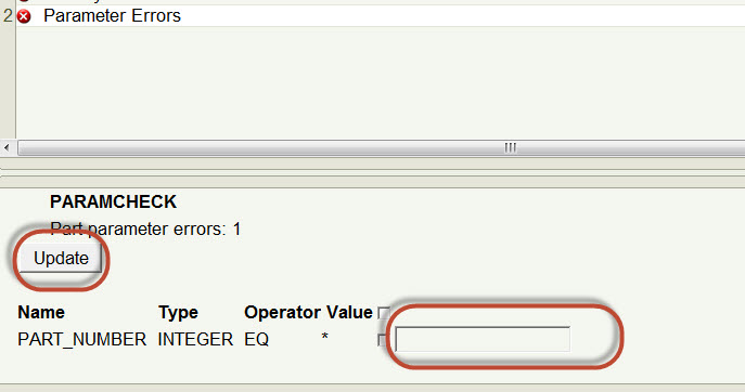

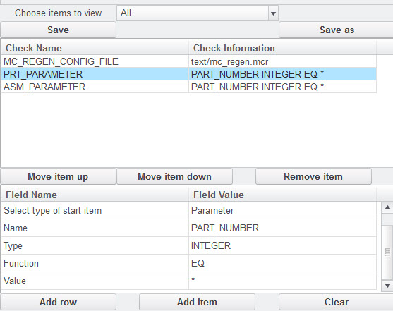

You can use ModelCHECK to change data type from String to Integer, however it will not maintain the existing values. Parameter will update only after defineing the value for parameter.
1. Set PARAMCHECK as E in check file.
2. Add Mode_PARAMETER PARAMETER INTEGER EQ * in start file (e.g. PRT_PARAMETER PART_NUMBER INTEGER EQ *)
3. Execute ModelCHECK, ModelCHECK will report Parameter Errors
4. Enter the value (You cannot skip this) in that and update parameter
