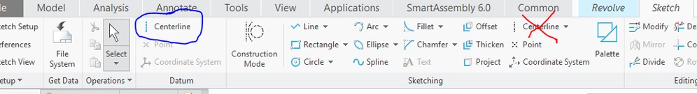

I am in the process of creating some ball bearings and am having difficulty creating the spheres. I watched a tutorial referencing Creo 2.0 on how to make one, but it seems that when I draw a half circle and insert an internal centerline like I thought I was supposed to, the revolve feature will not recognize those commands to create the sphere.
Help please!

Make sure you created a geometry centerline and not a construction centerline.

Solved my problem. Thank you very much!
