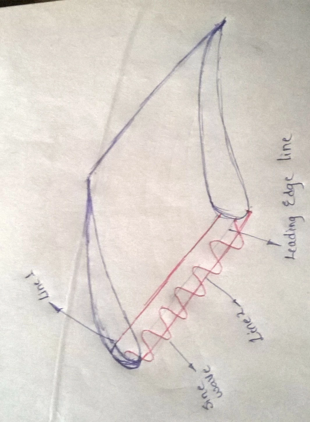

Hi all,
can anyone please help me how to draw tubercles as shown in the figure on an aerofoil blade attached here
blade.zip consists the iges file of the blade for which i want to add tubercles

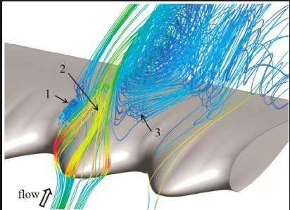

Some analysis extensions have the ability to output 3D data from the resulting analysis.
I am not sure I would tackle each curve on their own to mimic this process.

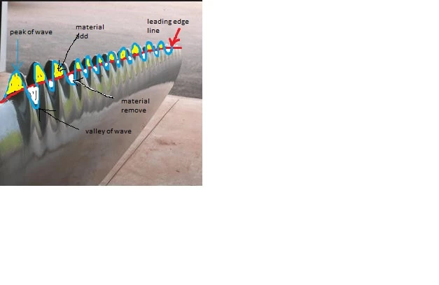

Hi TomD,
The image which I have attached is from google, so I don't have any data regarding it.
I'm attaching few more images and hand sketches.
Naveen
May 19, 2018
Right.  I am saying you would need to do the airflow analysis to capture the data.
I have done something similar with the lite version of the FEM analysis.
I would run the deflection analysis and output the deformed model in a facet format.
This file will maintain all the colors from the analysis as well as geometry I can query.
