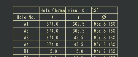

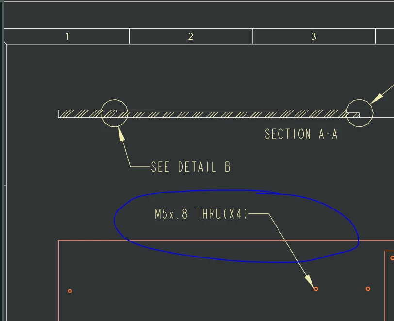

I am using Creo Parametric 10.0.4
I've created a hole table in my creo drawing and I want to modify the parameters in the hole table. For example, in the picture, the fourth column is the description of the hole and it currently reads 'M5x.8 ISO' instead of this I want it to read 'M5 x.8 Tap THRU'
Any ideas on how I can make this change.

Not exactly easy (to do or to explain), but you can use "standard holes" driven by custom .HOL tables.
Add a column "MY_DESCRIPTION" to the custom .HOL table and then display this "MY_DESCRIPTION" parameter in the drawing hole table.
Please read through the documentation "Using Hole Charts" and "About Hole Tablesbefore asking follow up questions.

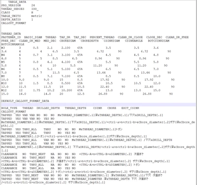

I think the best way is to use custom hole table.
Any text that you see with the hole feature is defined in a .hol file.
The contents of a .hol file looks like this, and you can open .hol file in any txt editor.
So, if you find the .hol file you are using and change ISO to Tap THRU, then restart Creo, you will see Tap THRU appear in your hole table instead of ISO.
If you do not always want Tap THRU, but other text depend on your design, you can create multiple .hol files, and choose to create holes from those file.
Multiple holes in the same .prt file can be defined from different .hol files. For examples, I have multiple .hol files and can choose from this dropdown menu each time I create a hole:
To find the folder of your .hol files, find this configuration option.
hole_parameter_file_path
If you do not see that option, then the files are in default folder.

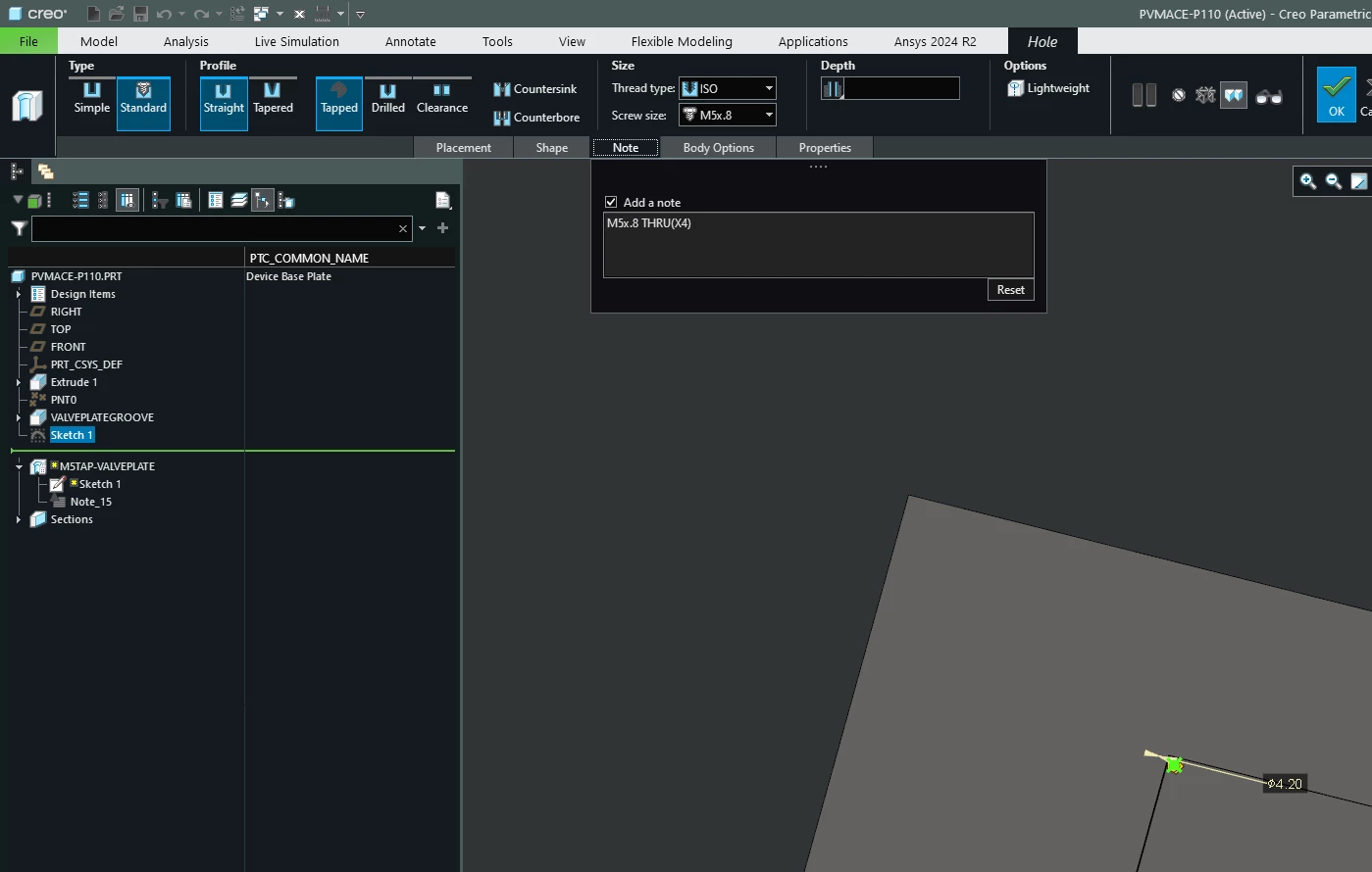

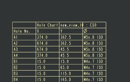

Thank you for the response.
I've updated the ISO.hol file. The hole description has successfully changed (see snap-1 & snap-2). but the description in the hole table hasn't changed (see snap-3). I've of course deleted and recreated the table a few times to ensure it's updated with the changes made in the .hol file.

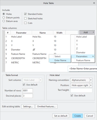

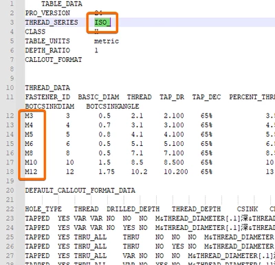

The default ϕ column is from .hol table, but it is not the hole note.
In the image above, the text M4 ISO_ is from ID and Series in .hol file
Although in the hole table, your note will not show, you can add parameters to show hole depth, boring diameter, thread depth, boring depth, etc.
You can control how the parameters appear in the table by editing "Name" column in the Hole Table window shown above.
The list of parameters can be found here.
https://support.ptc.com/help/creo/creo_pma/r11.0/usascii/index.html#page/part_modeling/part_modeling/Standard_Hole_Parameters.html
So instead of showing "M5 Thru" it is possible to show M5 <thread series> in a column and "Thru" in another column (indicating depth).
I haven't done it yet but maybe you can add your own parameter, as described in this answer
