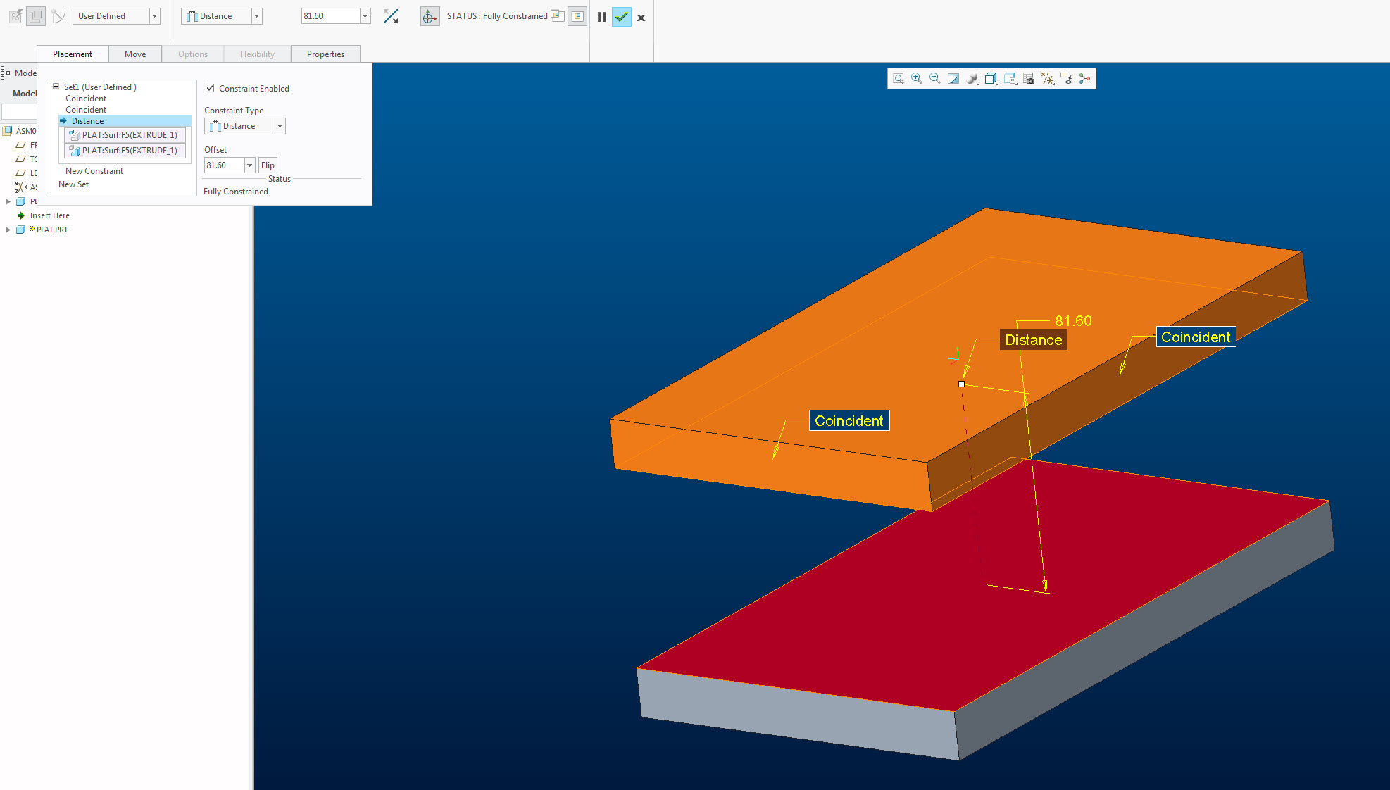

Hi!
When I try to change a Distance reference in the Placement tab, the constraint type changes from Distance to Coincident. It's like Creo treats Coincident as default and sets all new or edited constraints as "THIS SHOULD USE THE DEFAULT VALUE". Is there a way to get Creo to keep the constrain type, after a reference change, when it's previously been set?

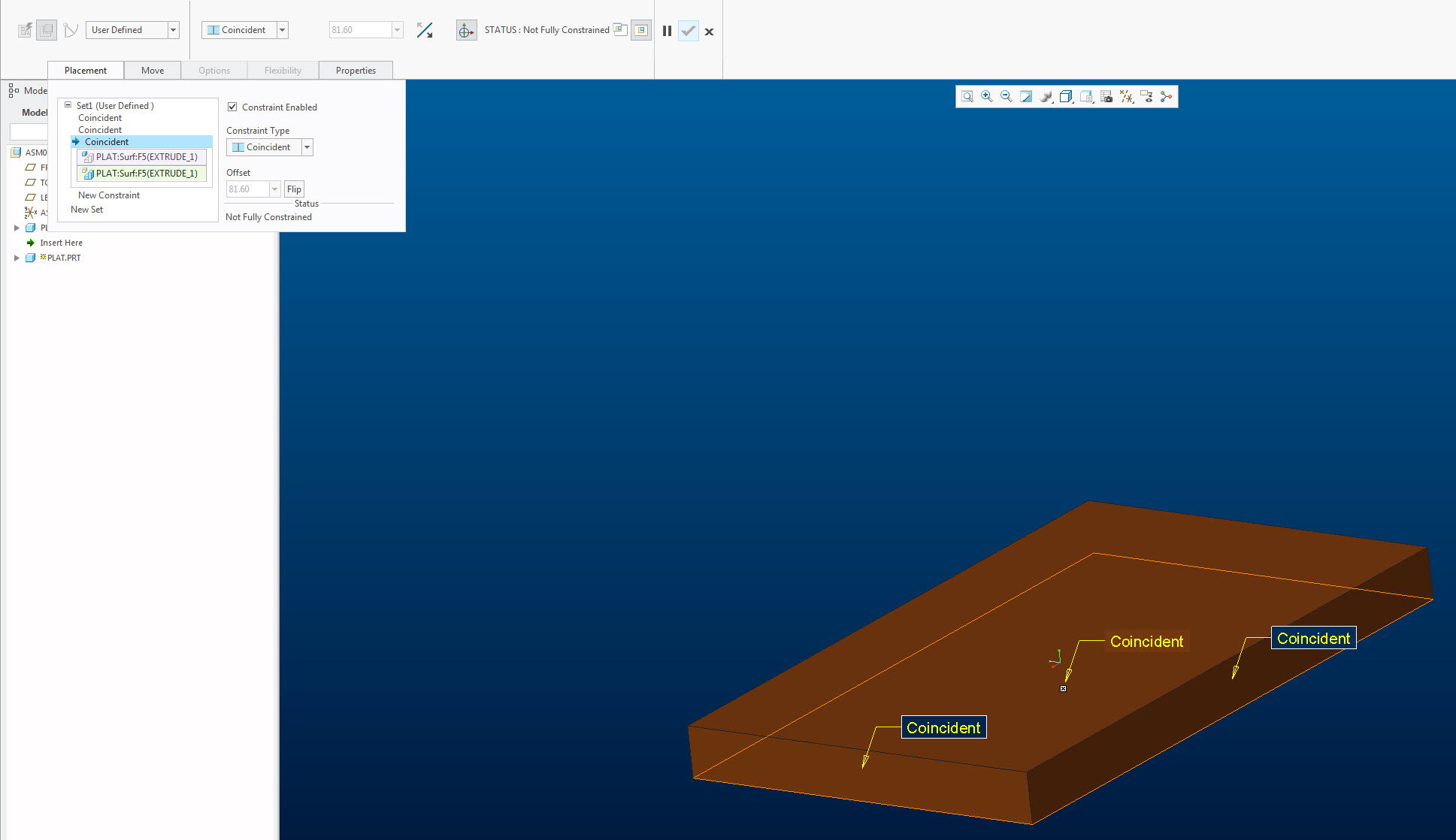

To clarify: I've got two parts where the bottom of the top part has been constrained to have a distance to the top of the bottom part with a offset value. Let's say I want to change the reference on the bottom part and have the distance to the bottom surface instead of the top. If I make this change via Edit definition > Placement tab Creo changes the constraint type to Coincident (but musteriousluy keeps the value offset value greyed out in the box). Why?
Before reference change
After reference change
Best answer by mcestnik
It's a config.pro option. You probably have auto_constr_always_use_offset set to never. That's why it changes it to coincident. If you set it to No it should work OK.

No, and it's maddening.  The software should not change the design intent on its own.
You may want to "Kudo" this idea:
https://community.ptc.com/t5/Creo-Parametric-Ideas/Assembly-constraints-should-not-change-to-coincident-when-set-to/idi-p/456284
In the comments there is a work around.  It's a bit of a kludge, but it looks like it allows you to keep the value anyway:
https://community.ptc.com/t5/Creo-Parametric-Ideas/Assembly-constraints-should-not-change-to-coincident-when-set-to/idc-p/456294/highlight/true#M1661

mcestnik14-AlexandriteAnswer
July 13, 2018
