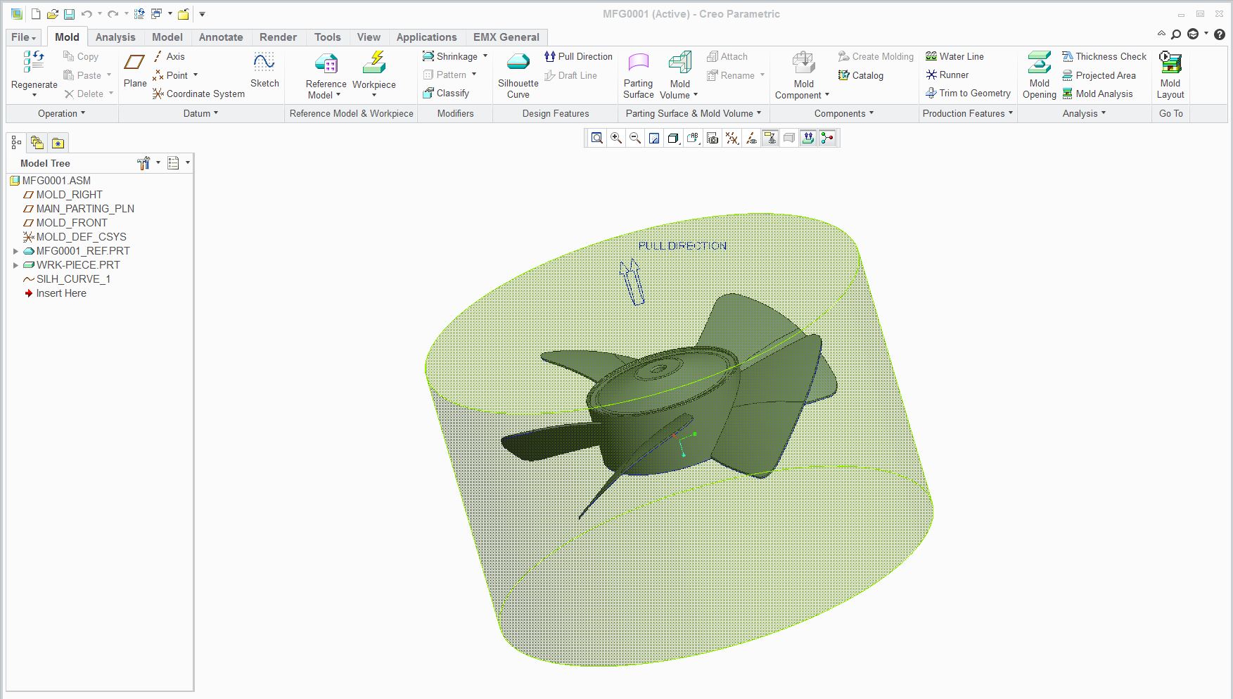

Hi All,
Is it possible to extract core cavity design for this fan model. I've tried to create parting surface but not yet successful.
Model is attached.
pls help!
Shashank

Dear Shashnk
Please attach file
I think you can follow to split cavity
Dropbox - hil-vt-08-005_blade.prt.3
Binh
bnguyen-212-AmethystAnswer
March 18, 2015
Dear Shashnk
Please attach file
Binh

Hi Binh Nguyen,
Thanks a lot for your help. it worked the way i wanted it to be. Extracted core cavity out of your suggested parting surface and the machined tool worked absolutly fine.
