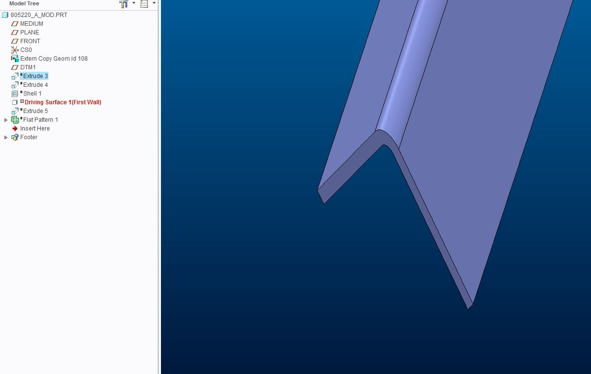

Here is the wanted geometry (pic below):

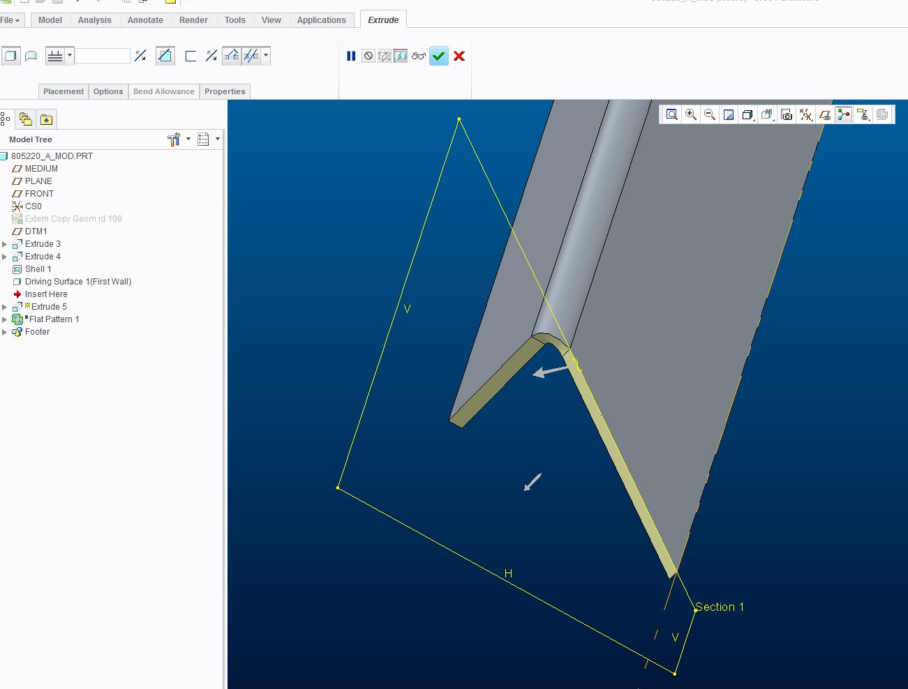

And here is the extrude cut step:
Is it possible to get wanted geometry working inside sheetmetal aplication, or do I must use some other feature or aplication ?
I´ve worked this in Creo 2 parametric.
Thank you in advance
Best answer by LndoVnBtchmrk
All you need to do is turn off the "Remove material normal to surface" button.
April 22, 2015
April 24, 2015
So obviously . Some time I just don't have time to read info message that automatically appear.
Thank you Andrew
Dale_Rosema
April 24, 2015
... and if that solved the problem, don't forget to mark the answer as correct.
