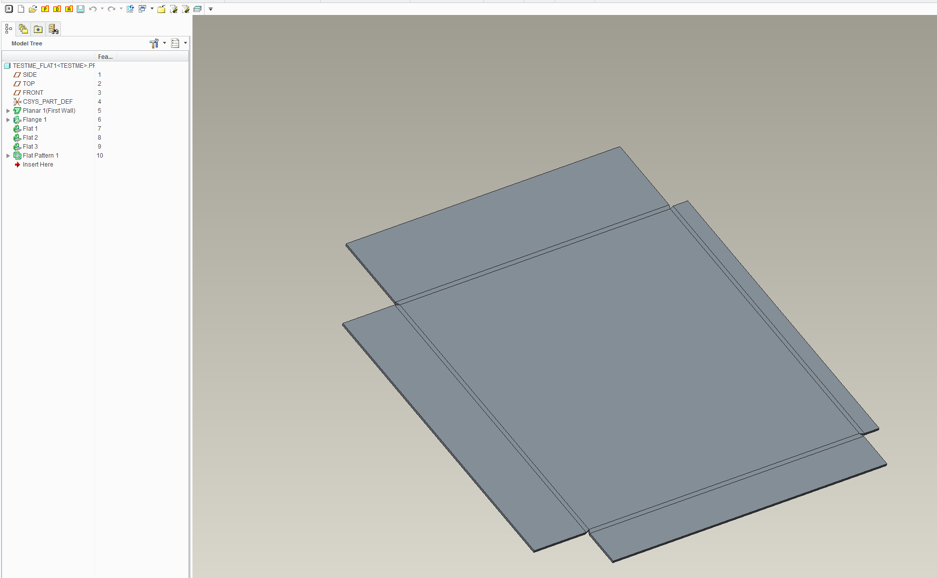

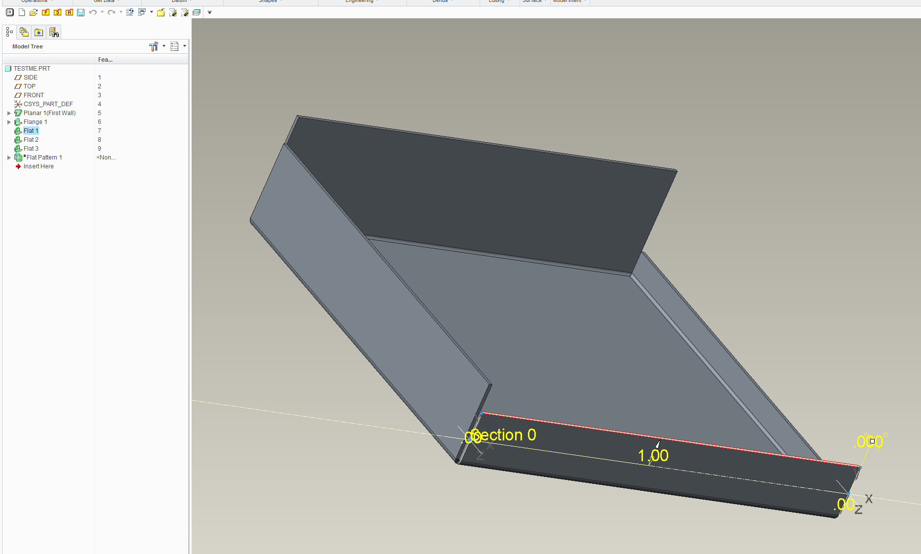

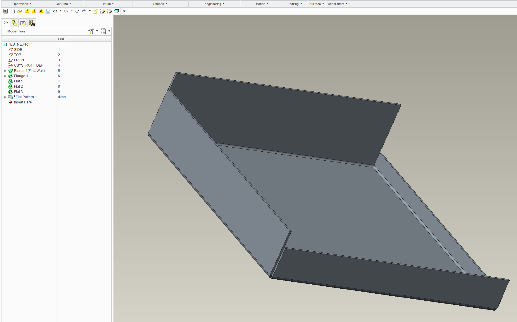

    I also use the chain selection for that type of panel as well, then I set mine to the shortest length and add FLAT flanges at 0 deg and the length I need.
    I also use the rip for the relief...works well in our shop.
    As you can see it flattens out nicely.

    No problem. I/we used to do it like you were until I discovered this method, a lot cleaner and allows you to change the overall panel size without any of the issues you get doing extrude. What's really cool is if you use FLANGE you can even offset the edges if you need to, another way to NOT use extrude!
