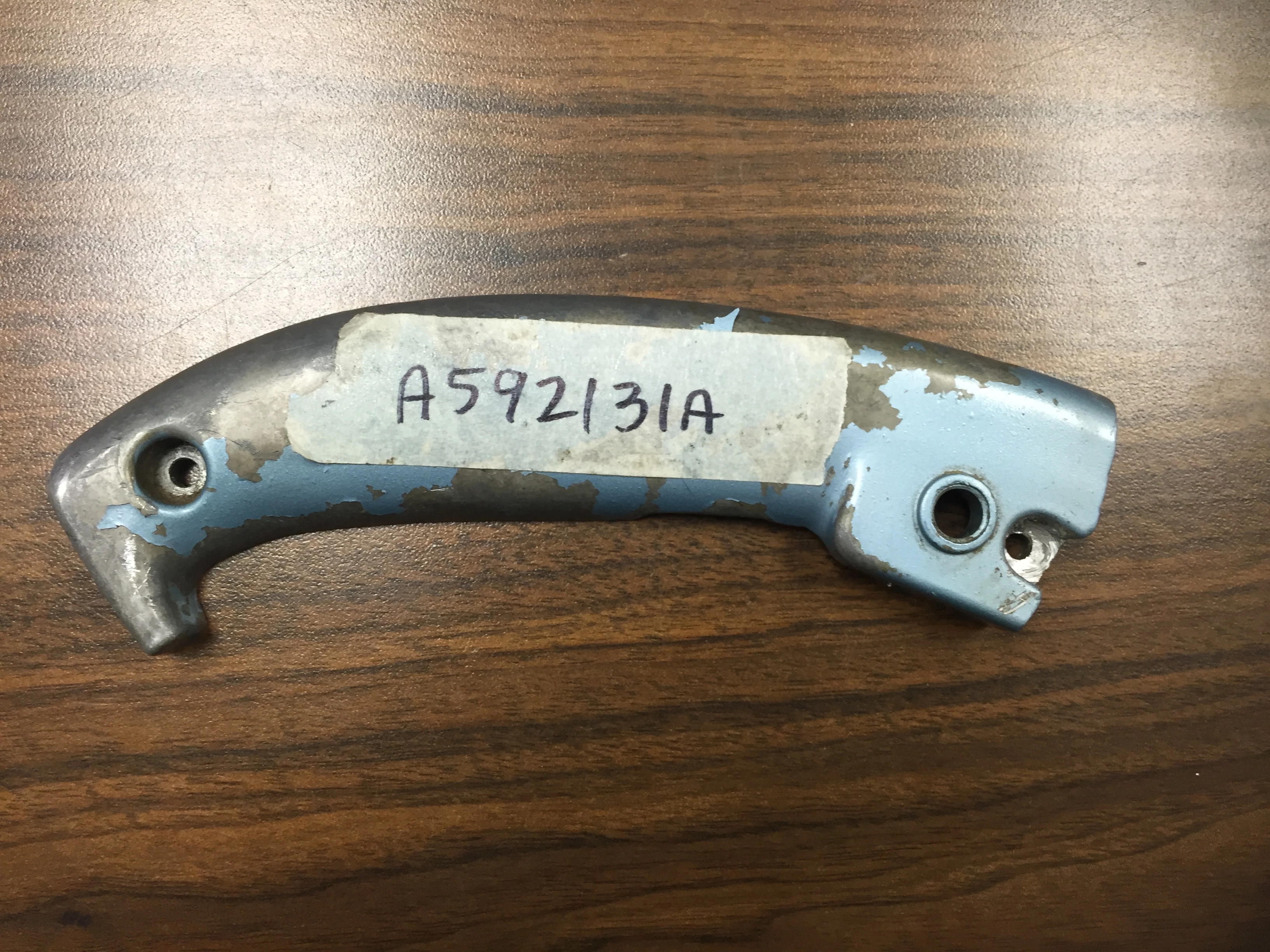

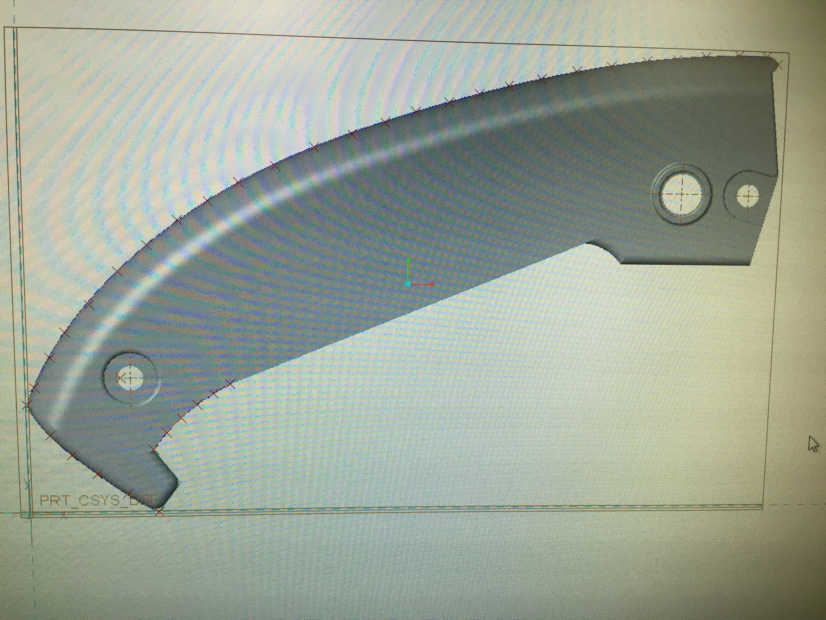

Hey guys.  So I'm fairly new to CREO, I'm taking my first class on it this semester.  For a term project we're required to model all parts of a chainsaw.  Right now I'm working on a piece with a noncircular curve and I'm looking for some advice on the best way to do it.  A couple things I've tried so far:
- Datum -> Curve -> Curve through points (I traced my part onto paper, made a coordinate plane to plot points on the curve (did about 25), and then used this curve through points).  The downside on this one is that although I tried my best to be accurate, measuring points to the 64th of an inch, they still didn't line up in a perfect curve.  However, this looks very close to the curve.  The only other thing is I'm not sure what the best way to dimension the part on my drawing would be (dimensioning 25 points would probably look terrible but again I'm new, maybe that's how it's done?)
- Tried plotting the points in the STAT of my calculator and then tried a few different functions for best fit line.  Downside to this is I can't get one that passes through my start and end points, which I believe is critical to the part.  Maybe there's another way to get a best fit line equation that will go through both of those points?  (I was planning on using the curve from equation to plot it this way)
Maybe I'm a little too obsessed with getting this perfect but I just want to learn the program the best I can.  Any ideas on the best way to go about this and the best way to dimension it afterwards as well?
Here's a pic of the part and what my curve looks like with the curve through points method.  The top is the curve I'm trying to get although it would help me in a lot of places to know the best method of doing it.
BTW, using PTC Creo Parametric 3.0
Best answer by mpoling
Nick,  You might want to try the Style feature in Creo.  It is still a spline, like the Datum Curve, but you'll have more control of it's shape.  You might also like to try a Curvature Analysis of your curve.
