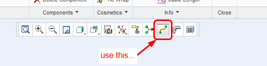

After I create a network and complete the feature the network disappears.  It is still there but not displayed.  Is there some way to have it always be displayed?
Best answer by lernst-2
Hi Chris,
The network will display when you turn off the "Cable" icon.  Use the "Wire" icon.  If you want the wires to show, you would use the "Cable" icon.  See below...

Chris,
I could be a couple things.  1) Are you in displaying Thick Cables?  If, the network will disappear.  Go to Centerline mode to see the network.  2) Is there a "Network" or "Curves" layer that is turned off?  If so, unhide them.

That was it.  Thanks guys

Hi Chris,
