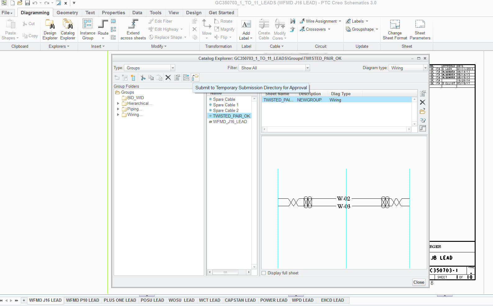

Hello people,
I create a custom block to be used in a Project, then I have another project where I can use the block created before, does anyone knows how to export ONLY the block and then get it imported in the new Project?
one thing that I have done is exporting my design properties then importing the desing properties in the new Project, the problem with that is that it export everything, does anyone knows a way to export/import only a specific block?
I appreciate the feedback

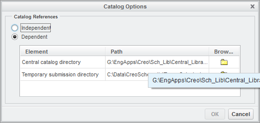

What does the Catalog button (next to the verify catalog button) show.
You need it to show as Dependent and with a path for the central catalog directory.
If it is set to Independent (your design will only use items in it rather than the library), you should not be able to even do a verify catalog.

Please clarify your meaning of Block.
If this is an Autodesk term, are you talking about a sketch you want to re-use?

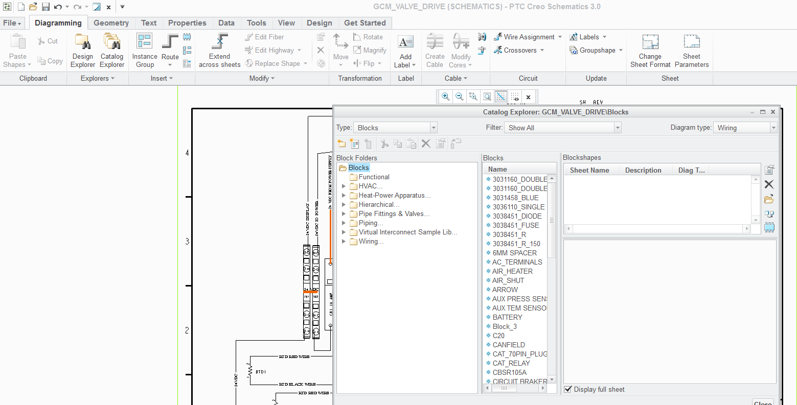

March 16, 2017
Oh,
I mean, at the catalog explorer, your artifacts are clasified as blocks, groups, fibers and so on...
for instace the picture attached shows you an artifact/block I created, how can I export it or make it part of the standard block group so that in the next Project it will be available?
I hope I make makeself clear
this picture shows a combined situation, i have my own artifacts plus the one that comes with the template...so every time I want to use those in another Project i have to export all the sheet properties then import them in the new Project, so everything gets copied twice

March 16, 2017
To use your block (group, fiber, etc) in another design, you have to be using the full version of schematics (not the demo version) and submit it to the central catalog (aka library).
Schematics is designed that local items stay local so that they don't collide with other items.
There is a way to do an end run around the system by exporting a design sheet and importing it into another design but the two versions that you end up with of your block are completely independent.  If you change one, the other stays the same.
If you submit it and save it in the library, other designs that use the same block will be notified of any changes that are made to it when they do a verify catalog.

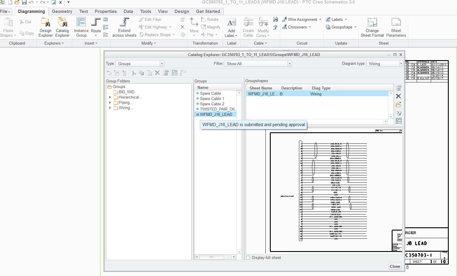

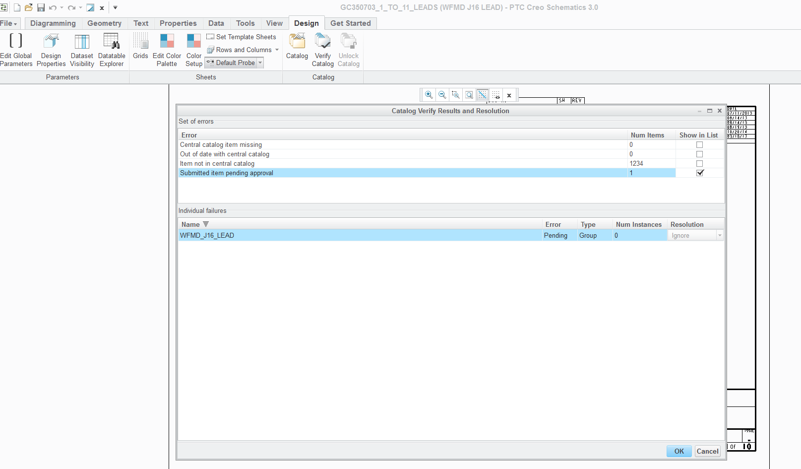

March 20, 2017
Ok
still some step missed,
I was able to "submmit for appoval my artifact/block/group"  however I do not see how I do the approval so that it becomes available for other files
you can see that it has a tag "has been submitted and waiting for approval"
at the catalog tab I click on Verify catalog however I see not any way to get it approved
what culd be the way to make the approval?
I appreaciate the feedback

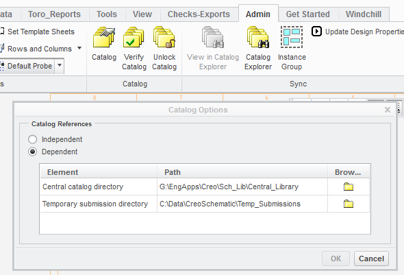

March 20, 2017
You won't believe how easy it is...
You have two file directories for this work, one is your temporary submission directory and one is the actual central catalog.  Note:  since I am using Schematics 2, this image shows the Admin tab.  It is renamed in Schematics 3 but is in the same place and has the same items in it.
All you do is move the files from the temporary submission directory to the central catalog directory.  The tree structure of the directories should match.  I just start at the root directory and say replace the directories and files.  That way I can edit a component and just overwrite the old one.
If your central catalog directories are not write protected, ANYONE can create a component and put it in the library.  Only people with a password protected design can open an existing component and edit it.

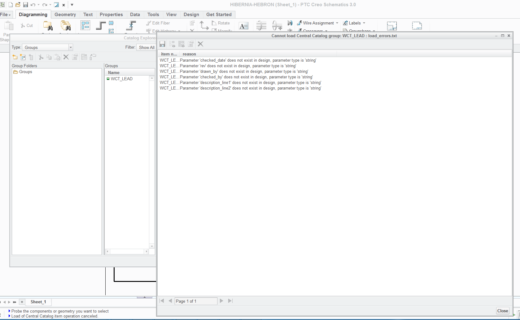

March 20, 2017
OK,
something else came up,
I move the files from the temporary folder to the central catalog, then I open a file where I want to use the custom artifact/block/group
it gives me an error
I tried to input those values at the global parameters tab however no luck. even at the sheet design it does not allow me to modify such parameters..why could be this?
March 20, 2017
OK,
No I do not have the file with password but I have fix the issue, I just deleted the parameters shown as they do not exist and now it works...
