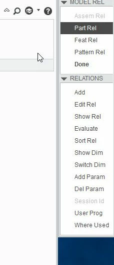

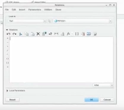

Hi All,
when i press tools >>relations
i am just getting
but i want
can anybody please help what wrong...
thanks!

Check with your config option "new_relation_ui".

Agree with Ketan, confgi option new_relation_ui controls the display of relation. If it is set as no, menu manager will populate on accessing relation. However with value as 'yes', which is default for config option, relation will populate in dialog box.

thanks! ketan it helps...now i can get the relation dialog box...
