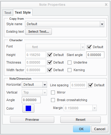

I would like to understand what DEFAULT alignment means for drawing note's horizontal justification.
Any suggestion will be helpful.
Thanks and Regards
Ketan

Default horizontal alignment means that:
  • note placed right of attachment point is aligned Left
  • note placed left of attachment point is aligned Right

Vertical alignment can be used for a text inside of a table's cell.
2-Explorer
May 11, 2016
Can't we use vertical alignment except table cell? I would like to set it for a note in drawing file.
May 11, 2016
There isn't a vertical alignment outside of table cell, but there is a similar concept, which is using @O to declare the origin line, so you can have the leader elbow going up to whichever line you like.
