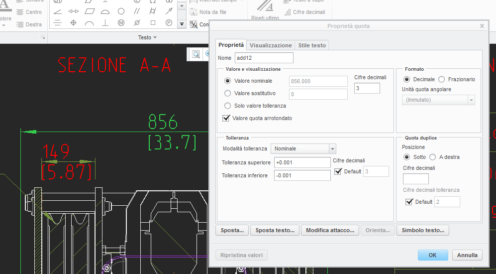

anyone knows how to set in format.dlt number of decimals for dual dimension?
Thank you.

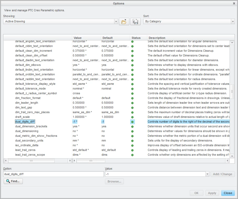

Best answer by BillChapman
dual_digits_diff will control the number of decimal places on the secondary dimension.
November 17, 2014
