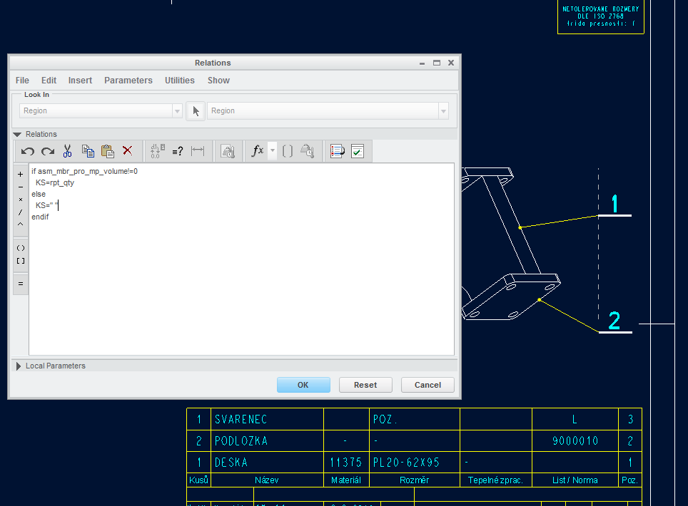

We must use a specific method of numbering (that cannot be driven by repeat region atributes) where each subassembly drawing contains total number of subassemblies and total number of each part. That's why we have to rewrite number of parts in each subassembly drawing manually.
My question is following: is there some way to sort this out so that its made automatically?

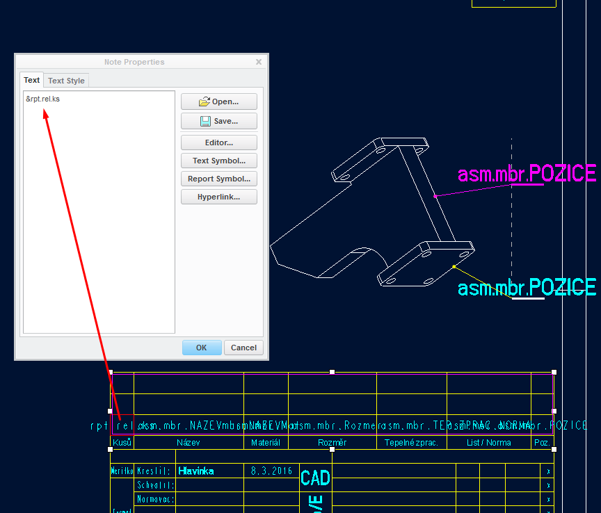

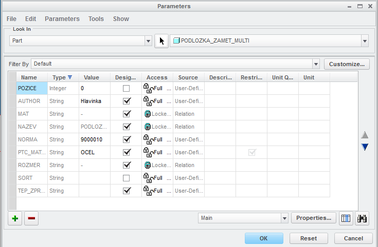

Sure, You might have a parameter called SORT (TRIDENI in Czech) in you start part defined as a type of string. So it appears in each model and can be used to sort the repeat region such that the &rpt.index will always start from number 1.
The trouble with this approach is with library parts such as bolts, nuts, etc., Those do not have the parameter SORT defined on model level. For those you would have to add a relation to the repeat region table that says if SORT does not exist define &rpt.rel.SORT equal to high number, else define &rpt.rel.SORT equal to &asm.mbr.SORT (actually the relation should be defined the other way around).
Finally, you will need to define a symbol for callout containing this \rpt.rel.sort\ as a variable.

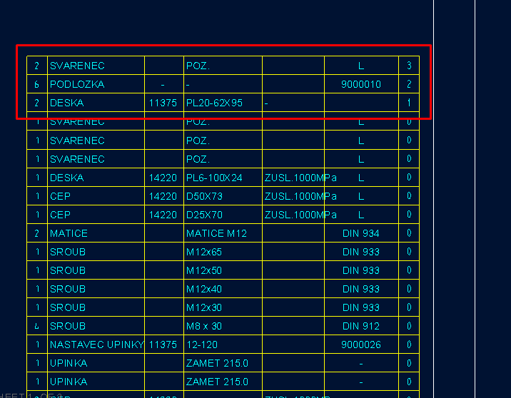

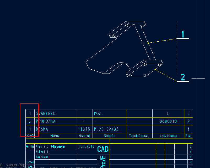

Since I am not good at relation I would like you to help me with the BOM relation. I made some screenshots:
- part parameters with newly created param. SORT.
- assembly drawing with total amount of parts
- subassembly drawing with "wrong" amount of parts (saubassemblies)

Ok, i see. This is a problem with the actual amount of each component, not with rpt.index.
Scratch what i said in my previous post about relations, sort, etc. Pictures explain it better.
This might be a little harder to grasp but let me try to explain... The subassembly by itself cannot tell how many times it is used in the top level assembly as well as how many times are used it's own parts in the top level assembly separately.
To get how many times the subassembly and/or it's parts are used you would have to load the top level assembly into the subassembly drawing and then change the Model/Rep in the table's Repeat Region to the top level assembly.
This solution creates two model/rep references in your subassembly drawing, one to the subassembly model, and one to the top level assembly model. You should think this through before using this solution in case you are going to reuse the subassembly in more than one assembly within Windchill. The need to reuse the subassembly could cause a havoc.
