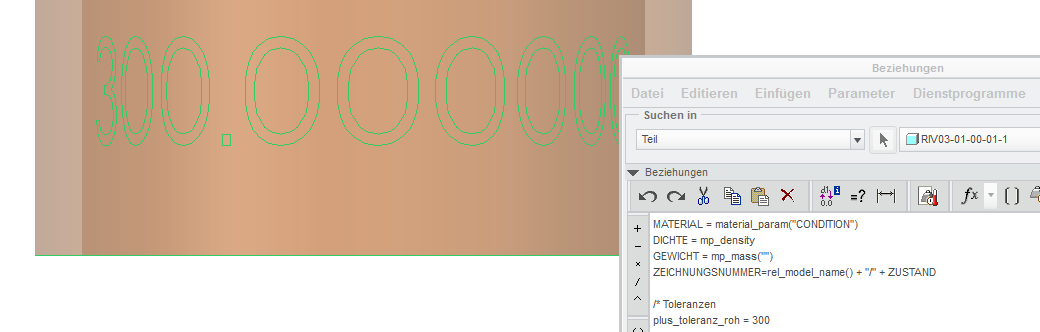

Hi everyone,
i want to "label" one of the parameters into my part. So far no problem using the text sketch tool and extrude feature. However, the text shows also all of its digits which means instead of "300" i get "300.000000", which makes it already impossible to get only one parameter labeled.
Is there a way to truncate the digits
Best answer by MartinHanak
  • create Integer parameter PLUS_TOLERANZ_ROH_INT
  • add relation PLUS_TOLERANZ_ROH_INT = plus_toleranz_roh
  • use PLUS_TOLERANZ_ROH_INT parameter in your "label"
MH
June 7, 2017
MH
June 7, 2017
you need to delete the existing parameter and create a new one of type "Integer".
no other way.
