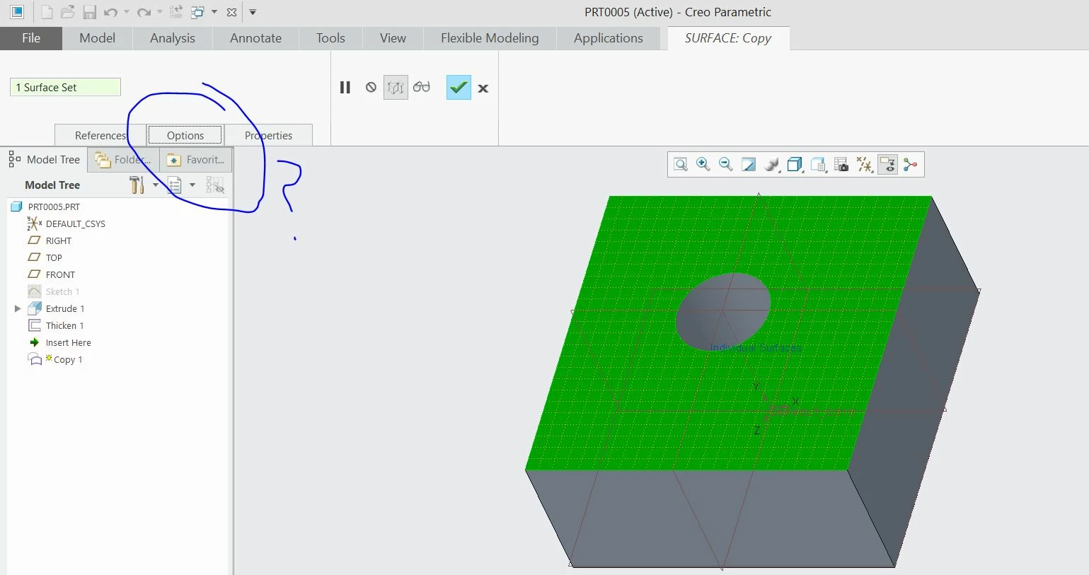

As the image attached shows, the "Options" drop down menu is nowhere to be found. I must have moved it and never re-anchored it and now it won't propagate anywhere on my screens.
Any suggestions besides restarting my laptop?
Thanks for the help.

@pausob wrote:
This sounds like the problem described in this thread:
'Placement' sub menu won't appear - what have I missed?
along with the solution to "reset" the GUI panel placements.
To clarify this answer, the solution in that thread is a link to another thread and the solution there isn't really what you want.  It's at the bottom of the second thread, here:
https://community.ptc.com/t5/Additional-Creo-Questions/Placement-disapperaed/m-p/288457/highlight/true#M25239
To save you the clicking, it says:
@Mahesh_Sharma wrote:
In such cases other option can be used to rest the position of panels. Option "Rest Panels Position" is available under File > Options > Window Settings "Rest Panels Position".

Interesting... I didn't know we could do that (Creo 3 onward).
How annoying 😛
Even more annoying is that it remains after you shut down and re-open.
Most likely the windows is behind the Creo window.
That makes it even harder to grab.
Try the Alt-Tab trick to see if you can grab the menu.
Alt-Tab will highlight -all- open windows, including Creo menus.
If it is outside your screen, you may need a second monitor with higher resolution to find it.
Or there may be other Windows tricks that I know nothing about.

Thanks guys, this solved it
