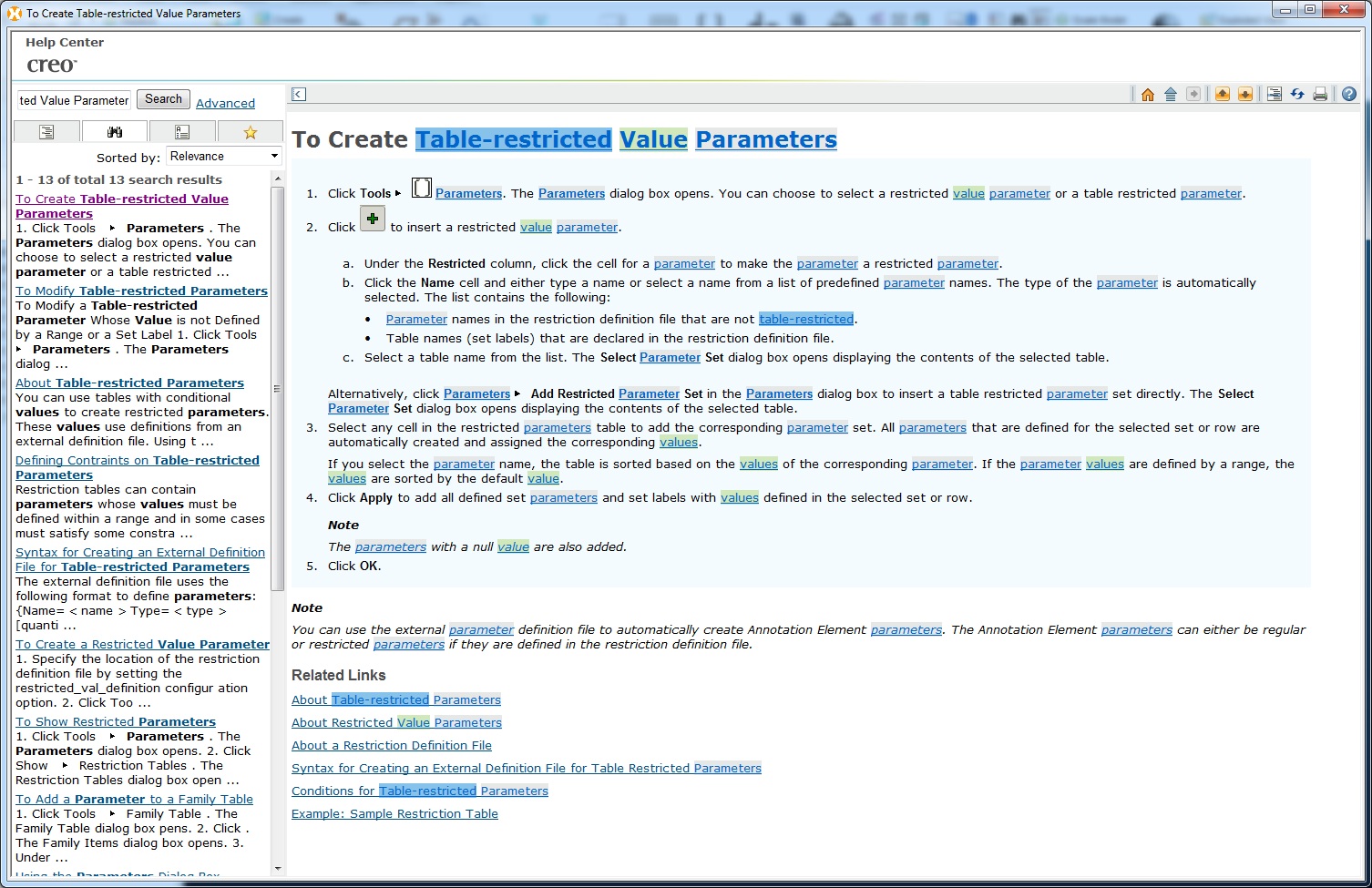

    Just idea, that could help you.
    Search ProE Help for: "Table-restricted Value Parameter"
    Generall way that l´m using thise function:
    IF material == steel
    than
    material_german ==stahl
    endif
    Hope it can help you...

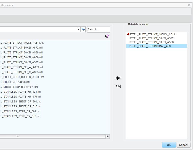

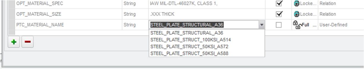

    Chris,
    If your primary reason for needing this revolves around material assignments, here are a few thoughts that may help solve your problem.
    Are you familiar with the system parameter "PTC_MATERIAL_NAME"? The first time a material file is added to a model, Creo automatically adds this parameter to your list of model parameters. As more material files are added to your model, this parameter automatically becomes a drop-down list which options consist of whatever materials are in your model. Capture2.JPGCapture3.JPG
    What our organization has done is developed a large library of material files which users can select from. They are also free to create new materials as needed.
    Alternatively, material files can be added to a Start Part model, so that referencing a library might not be needed most of the time.
    Hope this is somewhat helpful.
