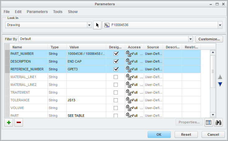

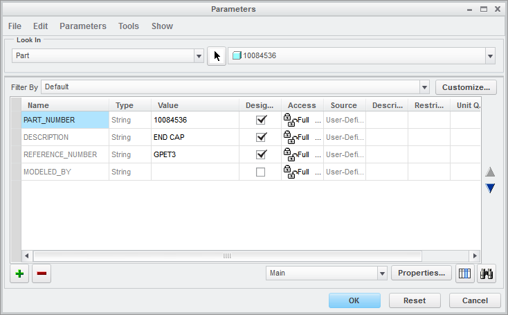

Thanks for reply ,This I know ,But I want , what are the parameters in the part model that same parameters comes in {Drawing(Main Ribbon >tools > Parameters>it will come (thats I want)}
This window for parameters in part model
this window for parameters in part drawing.
This is I want. Please reply .

To answer your Question.
delete the parameter (PART_NUMBER, DESCRIPTION, REFERENCE NUMBER) from Drawing parameter dialog box only.
go to the drawing and replace the template (.frm)
This will pick Parameter (PART_NUMBER, DESCRIPTION, REFERENCE NUMBER) from the Part.
I hope this helps!

Hi lokesh
It's not working.
I want part model ,parameters (dialog box having some parameters in string method ) , That parameters to comes on above part Drawing window (parameters dialog box )
