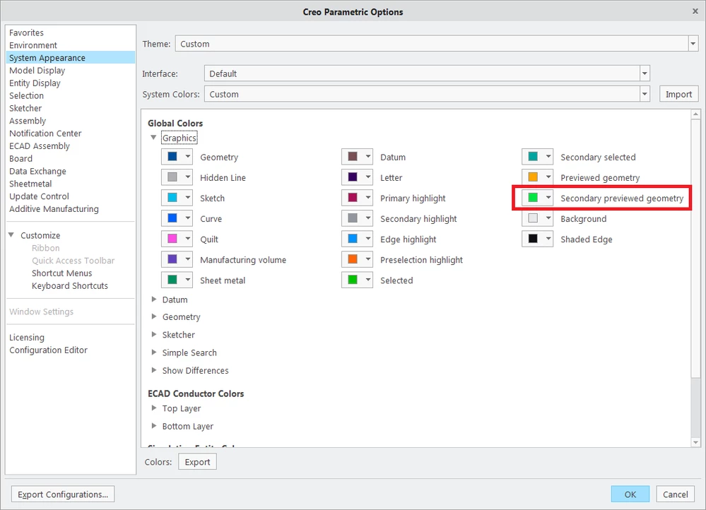

When I first started using CREO this wasn't an issue and I dont know whether it was something I have done but now every time I want to assemble a part in an assembly or an assembly into another, the whole model turns black.
I have attached a picture for reference. The grey model is the assembly and the black part is what I want to assemble onto it.

Problem related to graphics drivers. Reinstalling necessarry.

tip no.1
tip no.2
July 29, 2019
Thankyou for that, you are a lifesaver!
I must've managed to change it at some point, not realising my mistake ahaha
