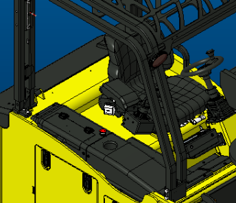

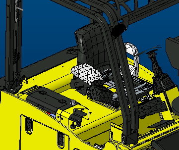

I have one computer that while rotating any assembly, parts will either disappear or show as like a white checker box. Its a new computer build using the same hardware as many others in the department, so I can't think of anything hardware that might be the issue... it very well might be though.
The pictures below are the same model. Left one is while spinning the assembly and the right is when you release it after spinning. Everything comes back immediately and just can't figure out what is going on. It gets very annoying when trying to check out fitment and the part just disappears...
Anyone have any ideas of what I could try?

That kind of looks like the level of detail option in the config which only comes in to play when spinning the model. Is the new system running the same configuration files as the other systems?
The config.pro options are:
LODS_enabled  YES/NO
LODS _value
It's also in the options dialog box under model display, look under the shaded model display settings for level of detail

Forgot to mention... Has occurred with the last 3 releases of Creo 3.0 we've used M060, M090, and M100.

I disabled that and now everything stays while rotating. Its set in our company config.pro, so I am surprised that only one person has this issue. I will just edit it out on their personal config and go from there...
Is this a setting for performance issues? You set it to a lower percentage if you have a lower performance machine???
