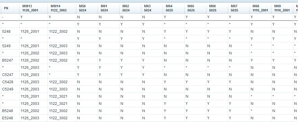

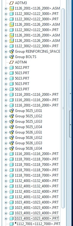

I have an assembly that when I open an instance, the parts are in the instance, but they are not it the generic. Typically I have seen these in generic, but suppressed. When I look at the family table, they are there, but it has a N for the generic. I am not sure if this was created in an earlier version of Pro and then the parts didn't show as suppressed in the generic.

I attached a couple of jpgs showing that the part is not in the tree of the generic, yet it is showning up in the family table. Could there be some sort of filter that I need to turn off?
