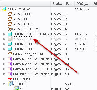

August 14, 2015
This part is hidden in the Model Tree

Correct , my part shows up not hidden in model tree or layer tree, just not visible in graphics area .
