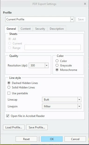

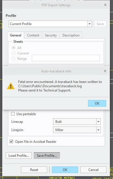

I am using Creo 5. While trying to save a modified profile of PDF export setting, my Creo is getting crash. See attached the error. I want to change the color setting to Monochrome and save a profile so that every time I don't have to change it again and again. Can anyone please help me to fix this issue, or please let me know where will be the default profile saved so that I can change the config in that file.

For PDF it will use the old mechanism for profiles, you can save the profile using save in export setting and get that on saving drawing to PDF.

This issue has been fixed in newer datecode of Creo 5.0.

Latest build for Creo 5 is Creo 5.0.3.0. It can download from PTC web under your customer number.
Also to have it install you need to uninstall earlier or upgrade the existing to newer one, in both of the cases installation is required.
BTW, options for Save or Load profile were not part of PDF export setting and that was causing the exit.
Without re-installation there is no solution.
