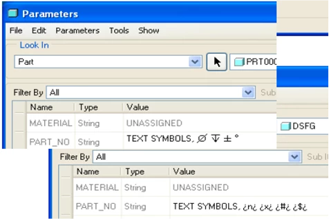

If you add a drawing symbol to a parameter, PDMLink appears to mess it up either during check in or check out.
Anyone have a solution.
The top one is before, the bottom one is after.
[cid:image002.png@01CB7B31.3204F230]

The problem is related to our start parts. PTC was able to reproduce the issue, and have assigned a severity level of High to the SPR. They plan to fix it in a later release of WF4, 5,& 6. (Wildfire 6.0 is what the spr says, not creo)
SPR
2033530
Status
Open
Severity
High
Created Date
15-Nov-2010
Last Updated
16-Nov-2010
Closed Date
Respond By Date
05-Dec-2010
Description
Windchill PDMLink is not recognizing text encoding when user using symbols characters in Pro/ENGINEER parameters value.
