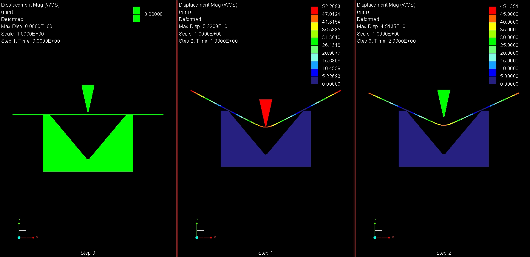

sorry
it's not for simulate (mechanica) possible
ANSYS etc
regards
paul
skunks
April 3, 2017
2d-example attached
regards
paul
skunks
April 3, 2017
color plot:
rrakos1-VisitorAuthor
April 3, 2017
Hello Paul,
it is OK but in your case, the STEP 2 is the bending tool back. In my case, an other tool (from other direction) should bend - initialized from the STEP 1.

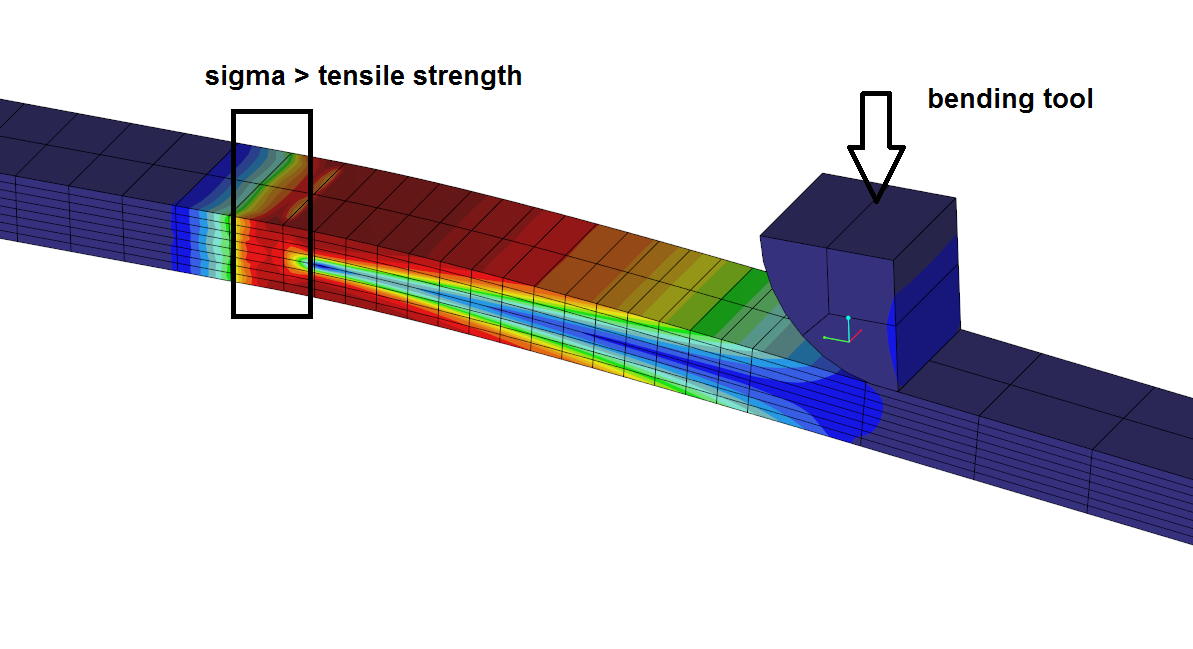

I have created some simulation to investigate the behaviour of material (stress distribution) after the reach of yield stress. (My material model is defined by a measurement)
I have a simple measurement with a small part. After the bending of this part, I investiged with microscope the outside surface of part. I see the the material - along the bending radius - reach the yield stress. But the part was not broken...so I think that the stress doesnt reach the tensile stress. Insipte of this, in the simulation, as it can be seen below, the stress is in red area in full cross section along the bending radius....colored by red means stress is over tensile stress.
It seems to me that creo solver estimates over the stress distribution. It shows that the part will break but it did not happen in the course of my measurement.
What is the reason in your opinion?

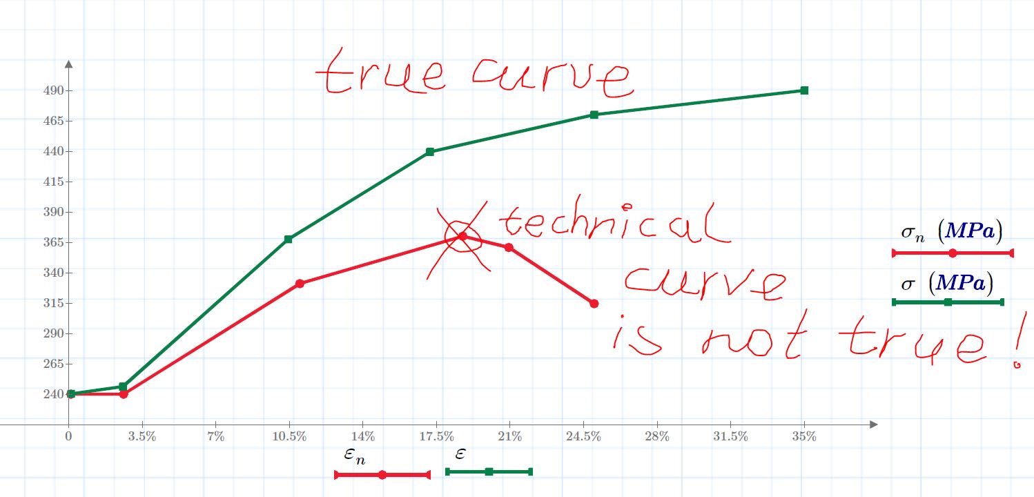

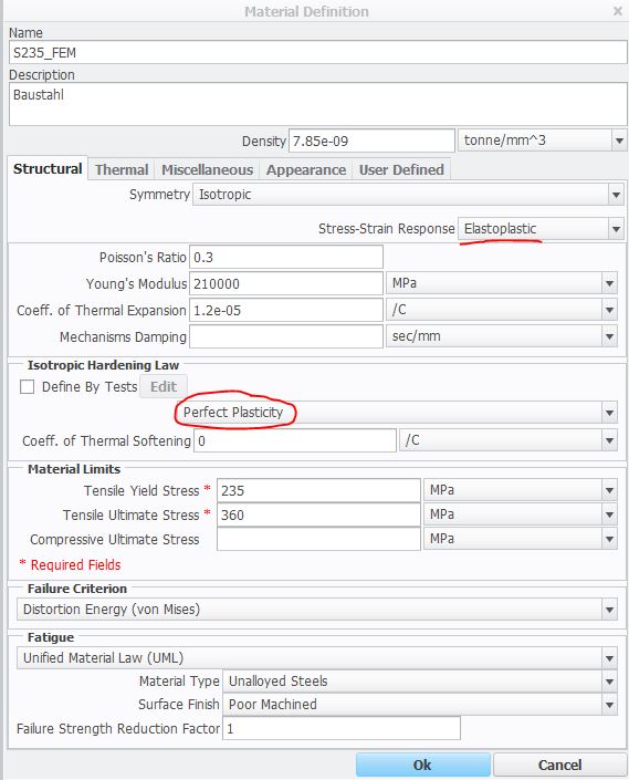

i used perfect plasticity:
technical curve is not real:
regards

OK, I tried the perfect plasticity model, the stress value did not reach the ultimate stress, but actually it is not possible caused by the perfect plastisity model:
If the stress value is higher than yield stress then it will not increase so it is evident that the stress doesnt reach the ultimate stress... In my opinion, this mode is ok for special materials but in my case it is not ok. I have a measured material curve and it is not similar to the perfect mat. model. The best case was the definition with the exponential law but it leads to too high stress value.... I dont understand it....
