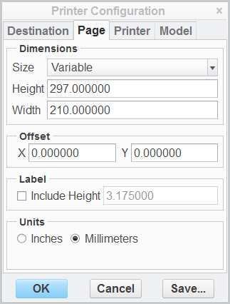

Hi all,
I have a little Problem with my pcf file. When I use it everything on the drawing is fine but it is turned 180°.
If I use MS_PRINT_MANAGER instead, everything is fine
This is a Problem because printing A3 and A4 I can normaly take the package of paper and clip it. In my case I have to turn all A4 drawings and then go to Clip the papers
This Problem is only with size A4 with layout Portrait. landscape is working fine. Also minimizing A3 on A4 is working fine when layout is landscape.

I guess that 180 degrees problem is related to the following line:
paper_size A4 default
When you print A4 portrait drawing created in Creo Parametric 2.0 you will get:
Test two variants in your pcf file:
paper_size variable 297.000000 210.000000 mm
-OR-
paper_size variable 210.000000 297.000000 mm

September 2, 2015
pcf as follows is working:
plotter MS_PRINT_MGR
button_name A4_TEST_MJH
button_help A4-Zeichnung auf Standarddrucker drucken
interface_quality 3 default
pen_table_file S:\ptc\02_CAD\01_config\eplplot\pentables\pen_table.pnt
paper_size variable 210.00000 297.00000 MM
!paper_size_allowed A4
plot_translate 0 0.2 MM
plot_translate has to be edited according to printertype
