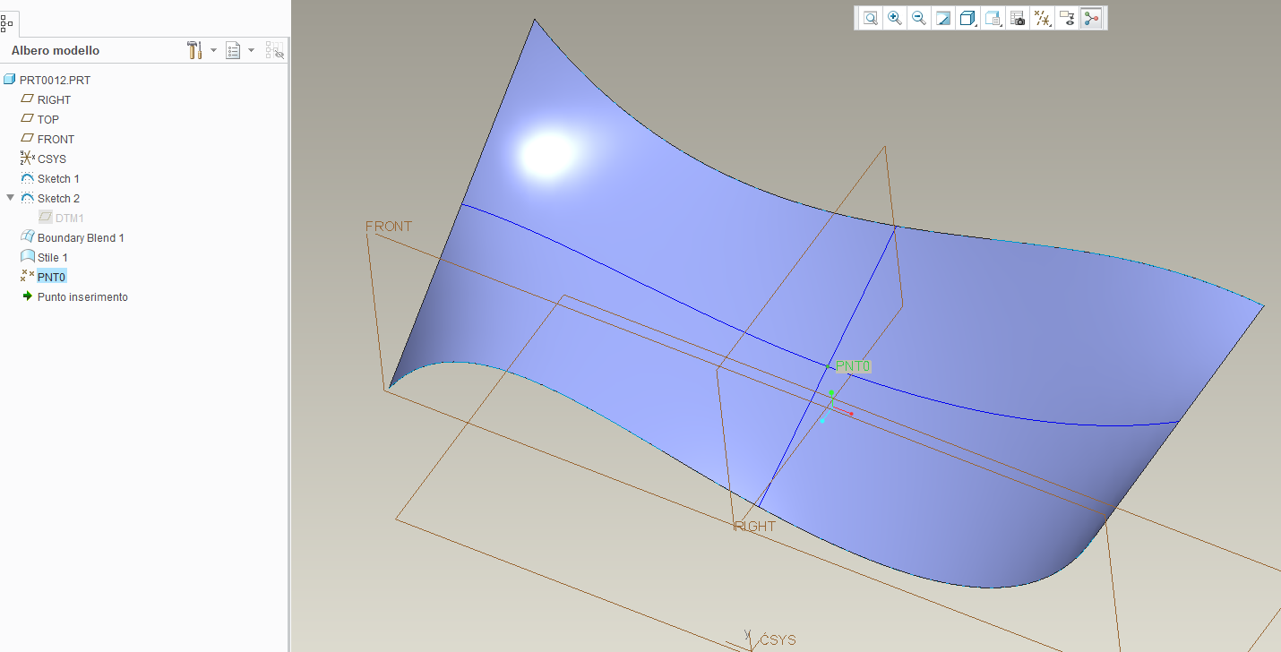

Is there a way in Creo to place a point, axis, or coordinate system at the U/V midpoint of any single surface?
Creo can place a point "on center" of a circular surface, but I would like to do the same thing with a rectangular surface.
NX has this ability. You can place a point on the center of any surface by giving it a .5 x .5 ratio of it's U/V lines. Is there anything like that in Creo?
If not, is it worth writing a product idea? Would you guys vote on it?

Best answer by MauroStefanovic
With ISDX module you can. Without i think you can't.

September 9, 2015

September 22, 2015
So, you need a ISDX license to preform this task, correct? There is no way to do it with out?
