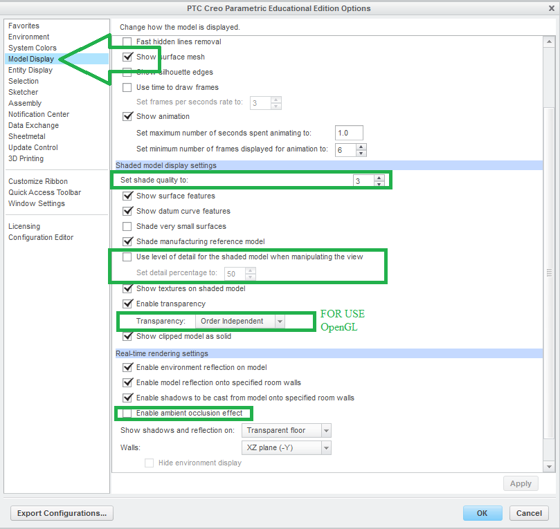

There is a way,
Go to options, notice that if your machine support OpenGL you should select "Other Independent".
The best setting to manipulate is "Set shade quality to", but notice that a higher number can decrease the performance.
