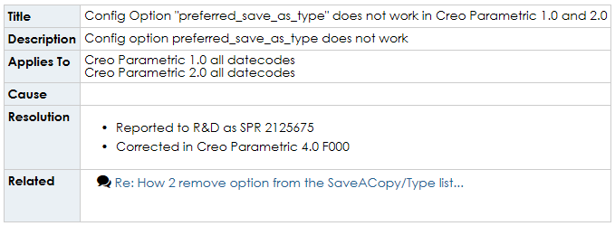

Hi everybody,
maybe a simple question, but I can't figure it out. I've included the following settings in my config.pro:
preferred_save_as_type PDF
preferred_save_as_type STEP
preferred_save_as_type DXF
When i open Creo these settings appear in the loaded configuration settings under File > Options > Configuration Settings. However when I create a new part and select File > Save As > Save a Copy the type list is still in default configuration. Am i doing something wrong or...?
I am running Creo Parametric 3.0 M030
Thanks in advance,
Dave
Best answer by TomU
It looks like PTC broke it between Wildfire 5 and Creo 1 and is finally fixing it in Creo 4.
https://support.ptc.com/appserver/cs/view/solution.jsp?n=CS61360
6 replies
TomU23-Emerald IVAnswer
September 1, 2016
