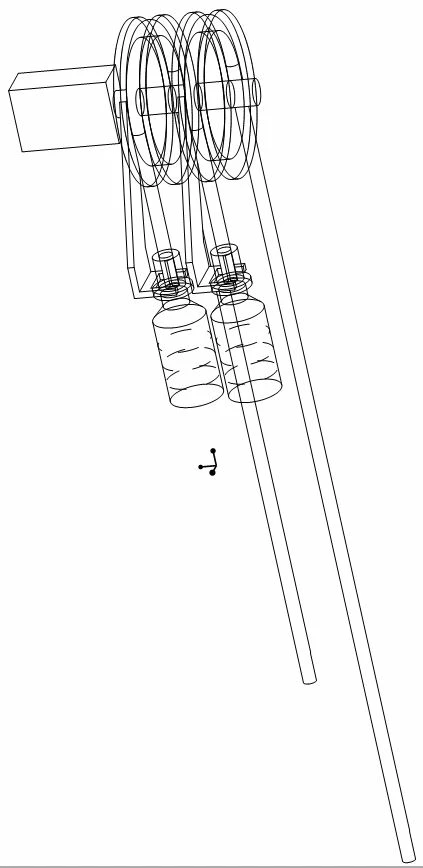

When printing an assembly in Creo 3.0 (be it to PDF or to PostScript) the print out is coming out in Wire Frame, with all hidden lines displayed. I want to print with No Hidden, which is the way I have the assembly displayed before starting the Print command. Is there a setting I am missing?

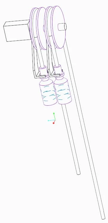

it seems to me that "purple" parts are not solid parts. Please check if these models have some weight -OR- if their weight is 0.
MH

Martin, how does one check if a part has weight? Also, if it turns out they are not solid parts, how can one turn them into solid parts? To my knowledge, I have created all of those parts in the same manner, but it is possible that I screwed up something somewhere (I am a beginner with CREO and all things CAD). To your point, I have created those parts with the REVOLVE function, and I think I did say "AS SOLID" -- but maybe I did not apply it correctly. Many thanks, Colin.
March 21, 2017
please upload assembly and part files using How to Attach a File to a Discussion Reply procedure. You can put them into zip file before uploading. I will check your data on my PC.
